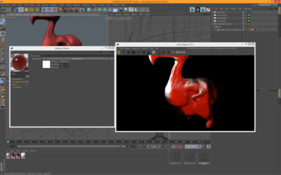

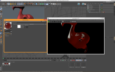

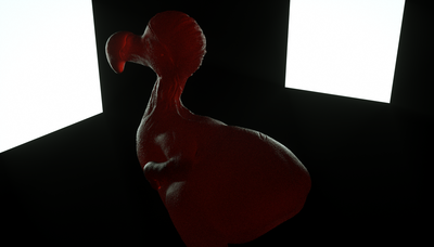

I'm having trouble with using SSS + diffuse and displacement in a mix material.
When I activate displacement in the mix material the SSS behaves very strangely becomes very shiny and bright and is unusable.
I've been tearing my hair over this all day trying to fix. Is this a bug or am I doing something wrong?
Any help would be greatly appreciated.

Hi Fanny, yes, the UV's were generated with UV Master. Iv'e found that when I try cubic or spherical mapping the problem goes away in the areas that cover the model, but obviously I need to use UVW mapping from Zbrush.
