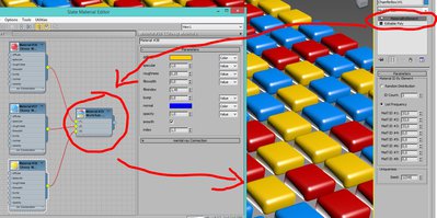

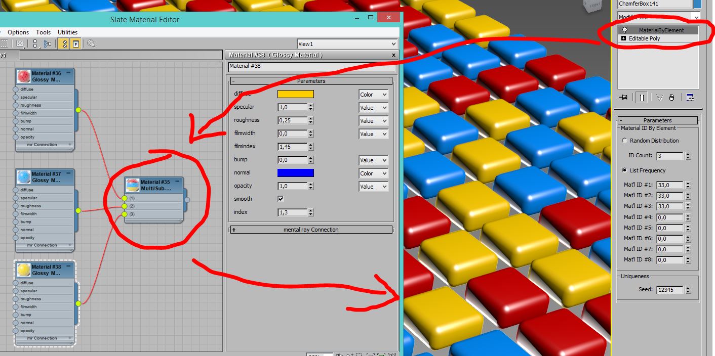

Try the modifier "Material By Element" :D
