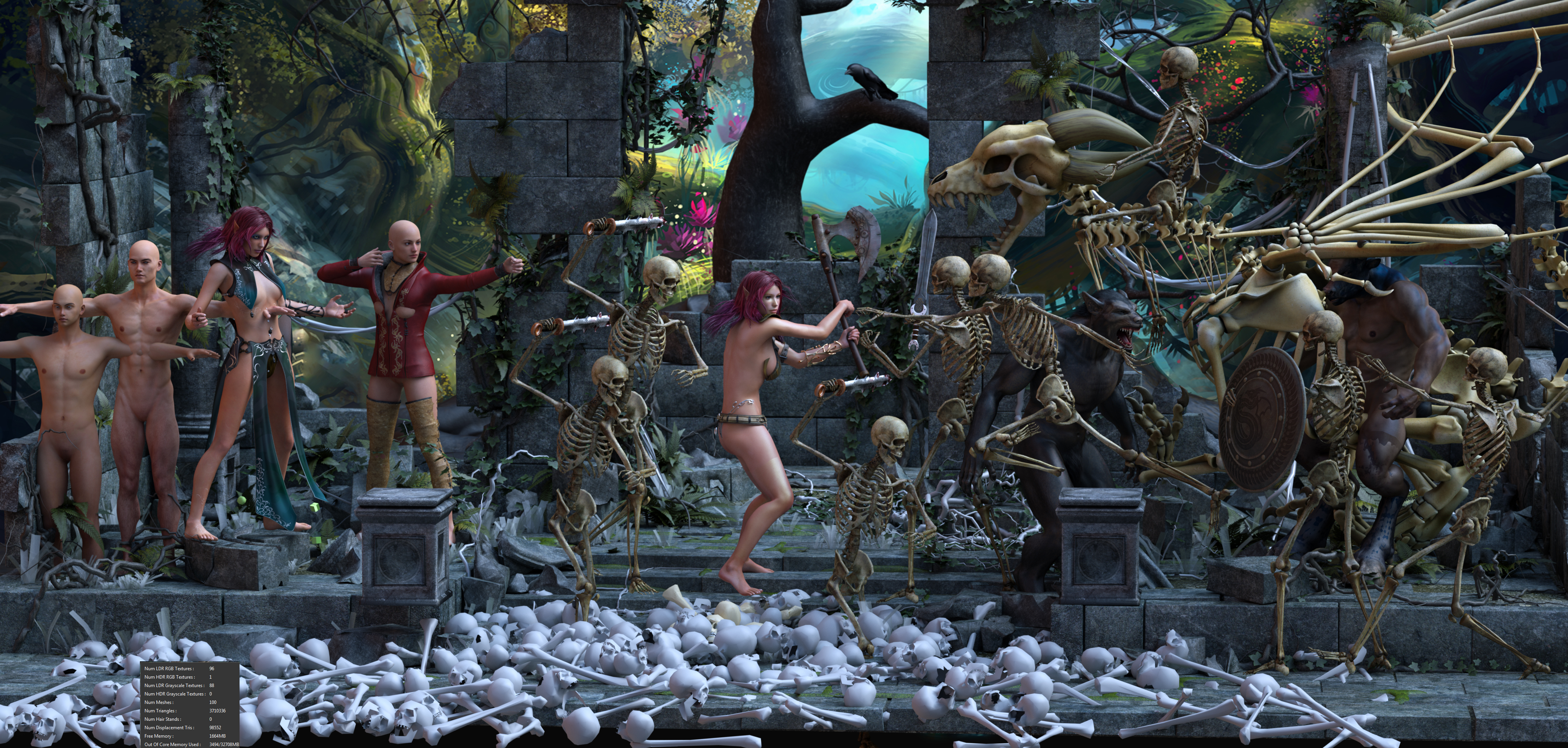

holy mother of hell
4091 x 1952 resolution
you will probably have to click on this picture a few times to actually see the bottom left-hand side if you're using the new feature
Added Out-of-Core Textures (yes keep clicking on the zoom function)
Please note that this is just a quick test scene I threw together (so some characters are not posed in the right angles etc blah blah blah blah blah blah
This possibly 15 characters in here
Paul let me ask you this question with my first initial tests of new feature
is any real point in buying a six meg graphics card now? Is this new feature is now being implemented

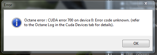

think sumthing to do with
Out-of-Core Textures -
as if disable it its fine.
keep getting this error
-> failed to deallocate device memory
CUDA error 700 on device 1: Error code unknown.

Firstly - reboot and try again. Make sure the plugin was installed correctly (the plugin version should show 2.21.1.41, and the Octane Log should show 2.21). Does it happen with all scenes, or just one?-> failed to deallocate device memory
-> could not get memory info
