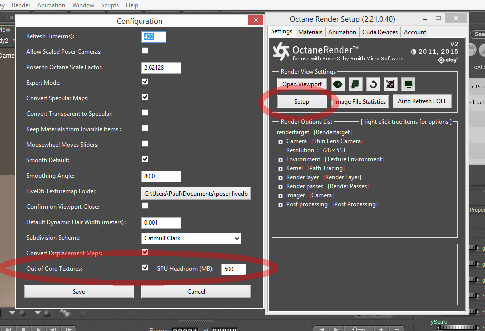

where can I enable - Added Out-of-Core Textures -? I didn't found it. I see only the out-of-core statistics.
Its a new checkbox in the Configuration window.
Paul
no new checkbox in the configuration window. will take a look tomorow.

Apophis wrote:
Paul
It's there, check the Setup button in the Settings tab of OctaneRender.
Pls see attached image. There is a bug preventing the switching OFF of Out Of Core textures which will be rectified in a future release.
