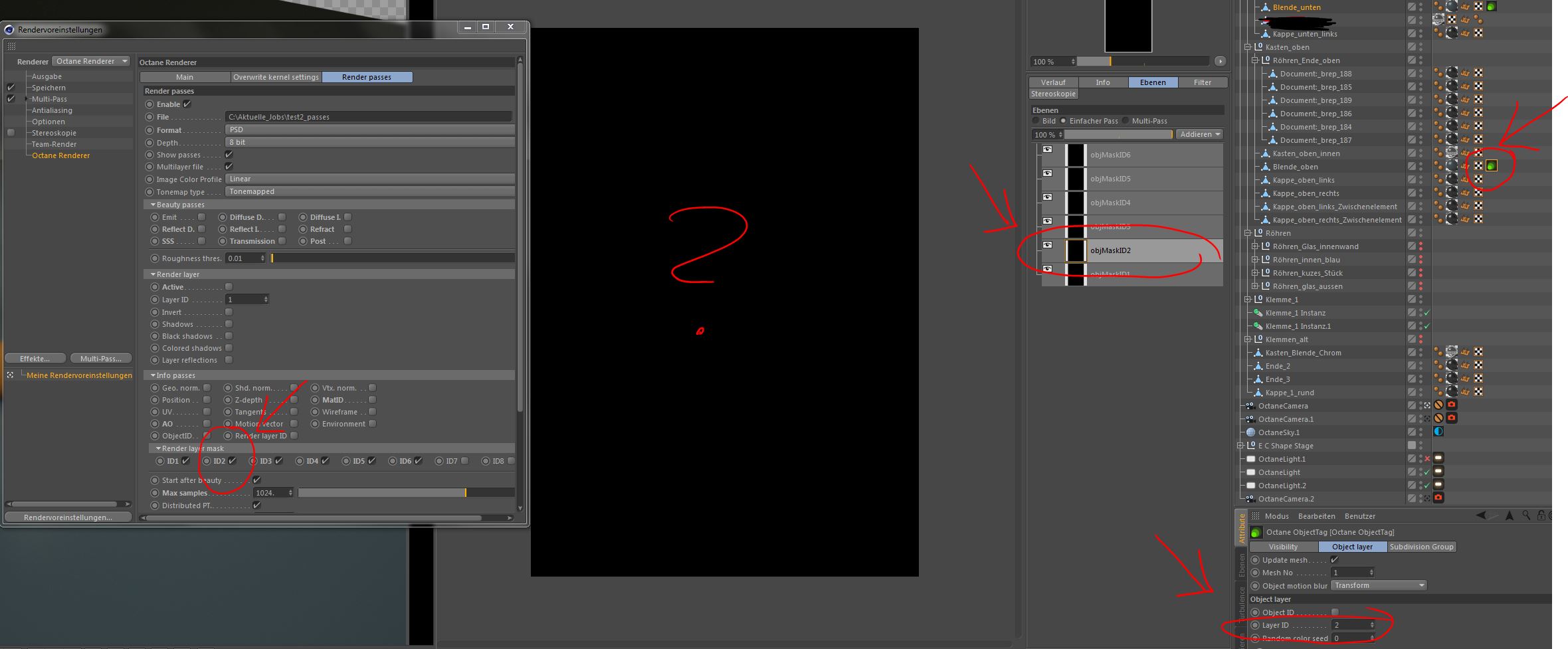

Hi Ahmet,
yes I did and it works in your scene.
But in my scene from 5 different masks only one is rendered and
also one object missing in the mask.
If no mask would render I would assume, that I've forgotten something.
But 1 mask is rendered and four other masks are rendering black.
Thats what I don't understand.
I just made a small testscene with a few spheres and there everything is
working properly.
But not in my scene!
Please see jpg example "ID2"! ID mask "2" is black.
What I'm doing wrong here?
thanks
MIke
Version 2.20.0 RC2 - Release candicate 2
Mike, have you selected render method2? not "send all data". This collect all to a single mesh and does not allow seperate meshes as indivual meshes.
in last version, method2 is default to avoid this kind of problems. It's capable to do everthing but can be slower. People should know the background of rendering if he want to use better.miohn wrote:Hi Ahmet,
no, I did not. It was set to "send all scene data"
I always forget to about this setting!
thanks very much!
Now all passes are rendering correct.
MIke

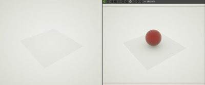

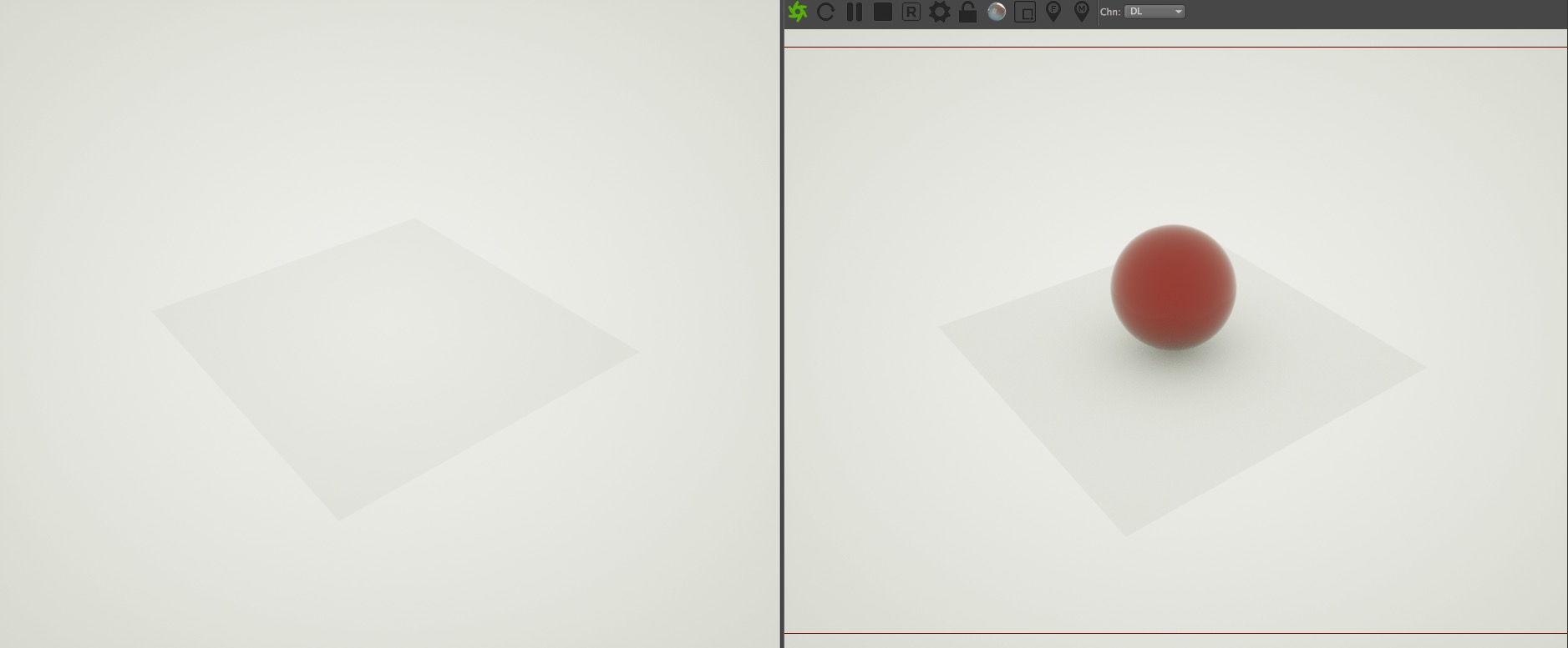

Hello,
In 2.20.0 RC2, i have a strange issue in my c4d viewer : some objects (the red ball in attachement) doesn't appear with the Octane Render engine.
In the Live viewer, everything is find.
Any idea ?
Any idea ?

oh again, please read first page of manual and FAQ.roinigo wrote:Hello,
Any idea ?
http://render.otoy.com/forum/viewtopic.php?f=30&t=40997
"Oh, again"...
Sorry for this... I will check the manual first...
