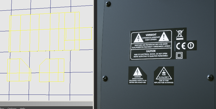

I have a problem at work I start to convert or workflow to Octane. some weird results at Octane with Texture overlays as usual I use texture alpha to cut the opacity and we cut shadow to have a kind effect it's work at Iray,Mentalray, Vray or Arnold.
at Octane this the result....(at the botton)
As you can see the mesh for the texts, I try to cut shadows cast or visible on reflection doesn't work the maya option also Octane to "Octane:Shadow visibility"
any Idea to have this result in good way quicker?

Hi Jolbertoquini,
Did you check the "alphashadows" box in the render settings? It might be that kind of problem...

ciboulot wrote:Hi Jolbertoquini,
Yes Thanks you Ciboulot is working better...Great I didn't think this option would be good for that I was use more to have shadow on the alpha with a catch shadow (matte option at diffuse node) :lol:
Anyway Thanks for the help :D
