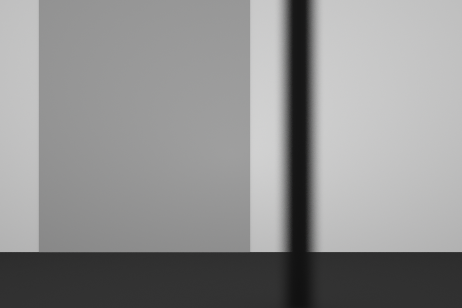

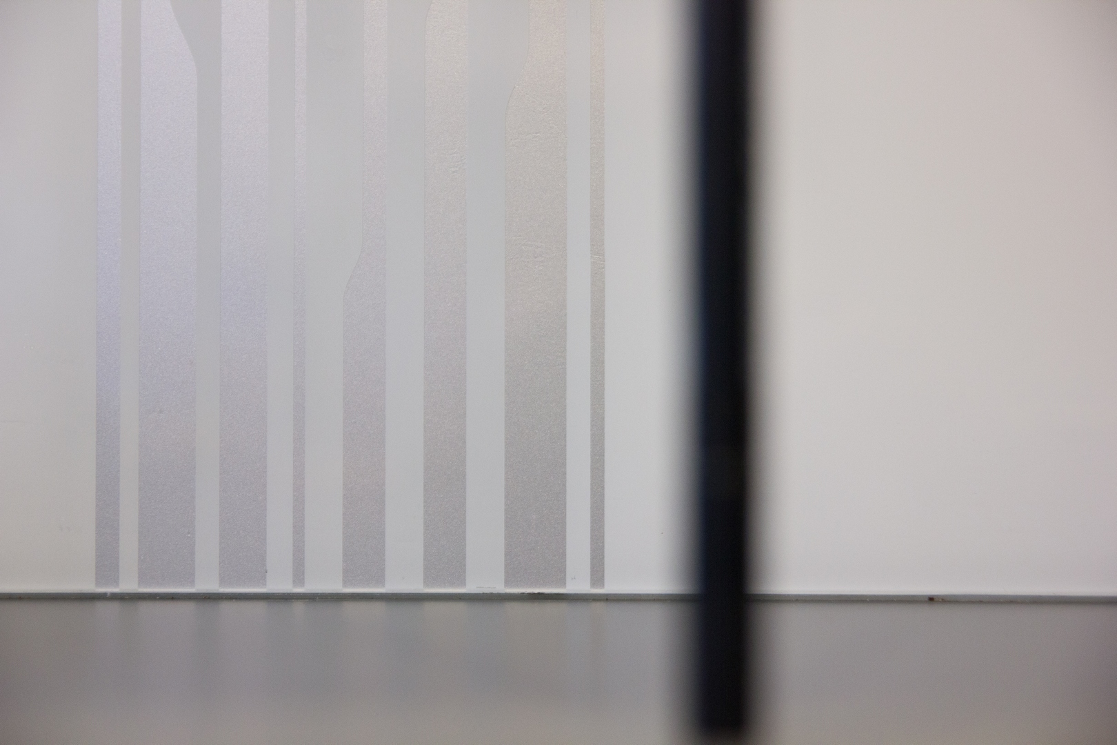

For fun and out of curiosity I did a little experiment to see how closely the Octane DOF matches a real world photo. So I set up a simple scene with a black pen in front of a white wall and have the wall in focus. I measured the various dimensions and distances and then roughly recreated the scene in Octane via C4D.
This is photo taken with a Canon EOS 550D (sensor size is is 22.3mm x 14.9mm) and a Tamron lens set to a focal length of 50mm and the aperture set to f/2.8 and processed in Lightroom:
And this is the approximated scene rendered in Octane:
In the image above, I set the "aperture edge" in the camera node to 0.8, but it's hard to get the bokeh into the same ball park, especially since Lightroom also applies some fancy non-linear response and the Tamron is certainly not the lens with the smoothest bokeh on this plant. But yeah, it's pretty close I would say.
This is how it looks like with an aperture edge of 0.5:
This is the scene to render the above image:
dof_test.orbx
(111.76 KiB) Downloaded 456 times
