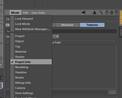

Is it somehow possible to use C4D's texture manager window to list all textures that are used by octane? Would be great to have a overview over the textures, olocalize them, globalize them or relink them to a new folder. The manager in C4D is great, only the link for octane is missing.

Not possible to support it. But you can use Project info->Textures to display and replace missing textures.
