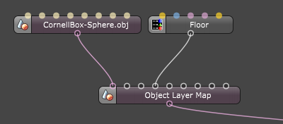

augdalmo wrote:goes well with single objects simple, but how can I do when I want to isolate from a surface an object that consists of 20, 30 or 100 items and more? it takes a lot of time and patience to connect all the nodes, there is no way of being able to consider it a single object?
have you considered this?
When I export from C4D what should I do?
If you assign an object layer map to your geometry node(s) but don't connect an object layer to each pin of the object layer map, the objects associated with the empty pins will all be on layer 1. What you then can do is only connect an object layer map to the pin of the object you want to isolate. For example in the picture, everything is in layer 1 while the floor is in layer 2:

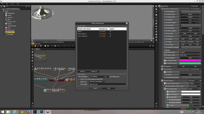

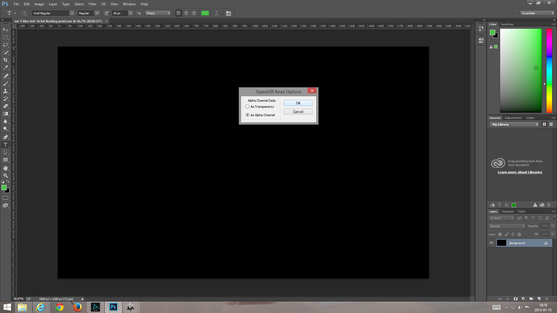

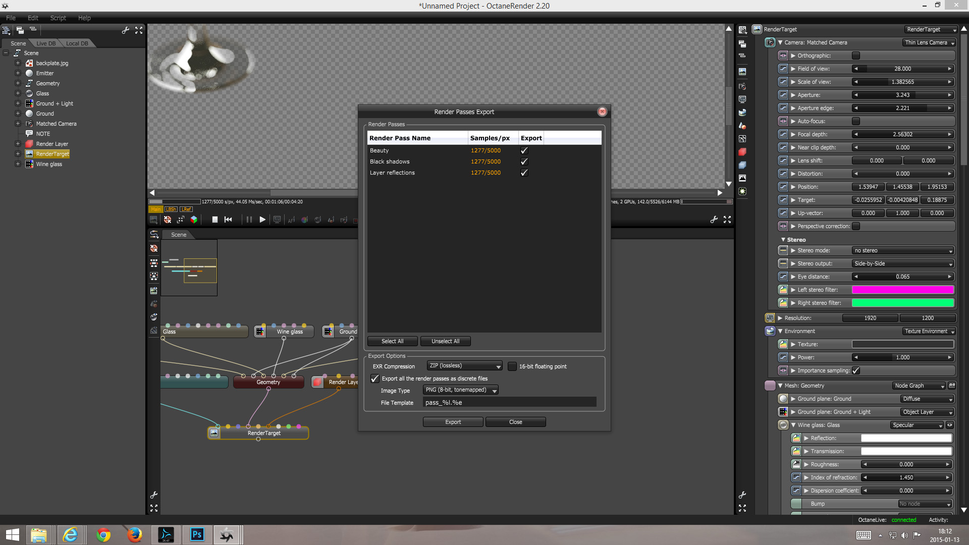

My three main questions about EXR are:
1) Is the default exported .exr file in 8 bit or 32 bit?
2) Do I need to select transparency or as alpha channel when importing in photoshop?
3) Does the EXR file support layers?
With the underlying question beeing:
Why do I just get a plain black image file when opening the EXR in photoshop?
obsolete parts edited and removed by user
When opening an EXR all I get in photoshop is a black image with one layer.<br />I did try to experiment with different 8, 16, 32 bit image modes.<br />What am I doing wrong?

I'll try to answer your questions.
EXR is always 32-bit or 16-bit per channel. It's a file format for high-dynamic range images developed by ILM. You can get more information here. EXR is the best suited for a linear workflow as described here.
Yes, EXR supports multi-layer files. So you can export all your passes into a single file.
To use multi-layer EXR files in Photoshop you will need a plugin. Have a look here.
We had a look at exporting .psd files from Octane but there are only libraries available that support older formats and writing our own library would eat away a lot of our time.
