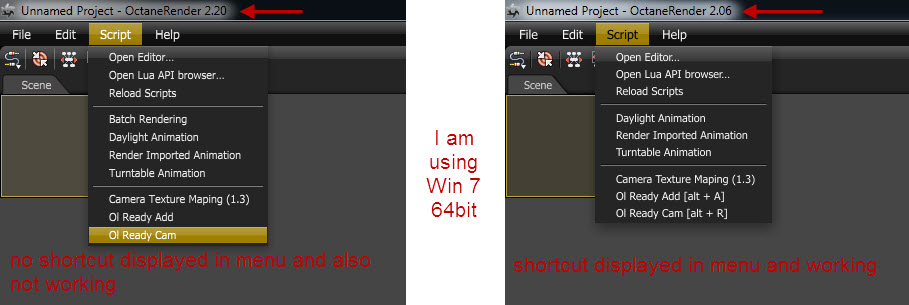

LUA Script shortcuts seems to be not working in this version 2.2.
It is working in 2.06. here.
Thanks.

jitendra wrote:LUA Script shortcuts seems to be not working in this version 2.2.
Thanks.
They are working on my system in 2.20. What OS are you using and which shortcuts do you have assigned?
Thanks.
cheers,
Thomas
Hi Thomas, I am using windows 7 Ultimate (64bit).
Can you also let me know, how to assign the shortcut manually in .lua script? Thanks.
