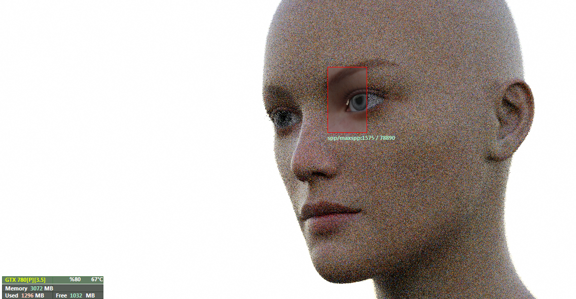

I´m having some problem with an opacity map for eyelashes.
It´s strange because it only shows up in some camera angles..
I´ve tried to change gamma and texture power but nothing helps.
Maybe this has nothing to do with octane but I wonder if any of you have had the same problem..?
Texture maps come from Daz Studio so I think they are ok.

propably need to tweak rayepsilon because of small distance between surfaces.

That worked, but now rayepsilon is 0. Is that ok?

bobb82 wrote:That worked, but now rayepsilon is 0. Is that ok?
Thank you for the fast reply!
What do you enter, zero? number controls has not high precision to display. But can hold small values then 0.001

Yes. But I cant type in less than 0,001. But when moving the slider I can get 0.00054. Seems like the slider dont allways work like you espect it to..
Anyway, I will try and get the lowest value.

bobb82 wrote:Yes. But I cant type in less than 0,001. But when moving the slider I can get 0.00054. Seems like the slider dont allways work like you espect it to..
Thanks.
you can but does not display. You can test it with "Edit in standalone" command

Ok. Then it´s allright.
