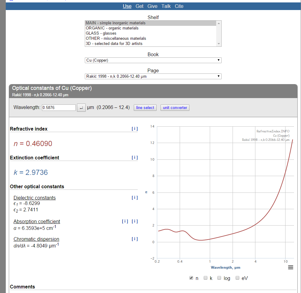

roeland wrote:
Tugpsx wrote:Super nice so we can go wild and add this database to a pick list.
A complete IOR list
You can use the indices in this list in the specular material node for things like glass or liquids. The values for metals are not useful because it doesn't include the K values.
Roeland
This may help
http://refractiveindex.info/

smicha wrote:
A complete IOR list
Roeland
This may help
WOW! awesome find, now to combine both to produce a dropdown list and all would be great.

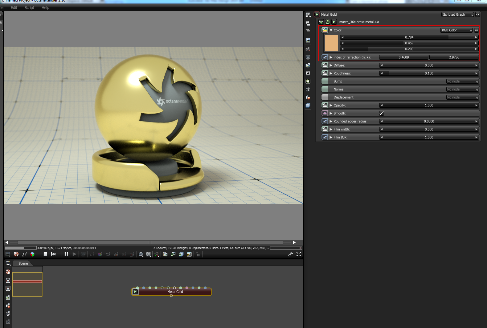

Elvissuperstar007
Posts: 2619
Location: Ukraine
the script does not work
It's not like copper
prodviz
Posts: 543
Joined: Sun Jul 14, 2013 6:00 pm
I don't know if it's 100% accurate, but looks realistic to me.
Especially in Path Tracing or PMC.
Would still like to know if these material settings will, or can be available in maya?

roeland
Posts: 1826
Updated the script — fixed bug where the metal had the wrong falloff after loading a scene and added icon.
