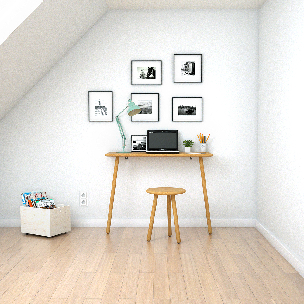

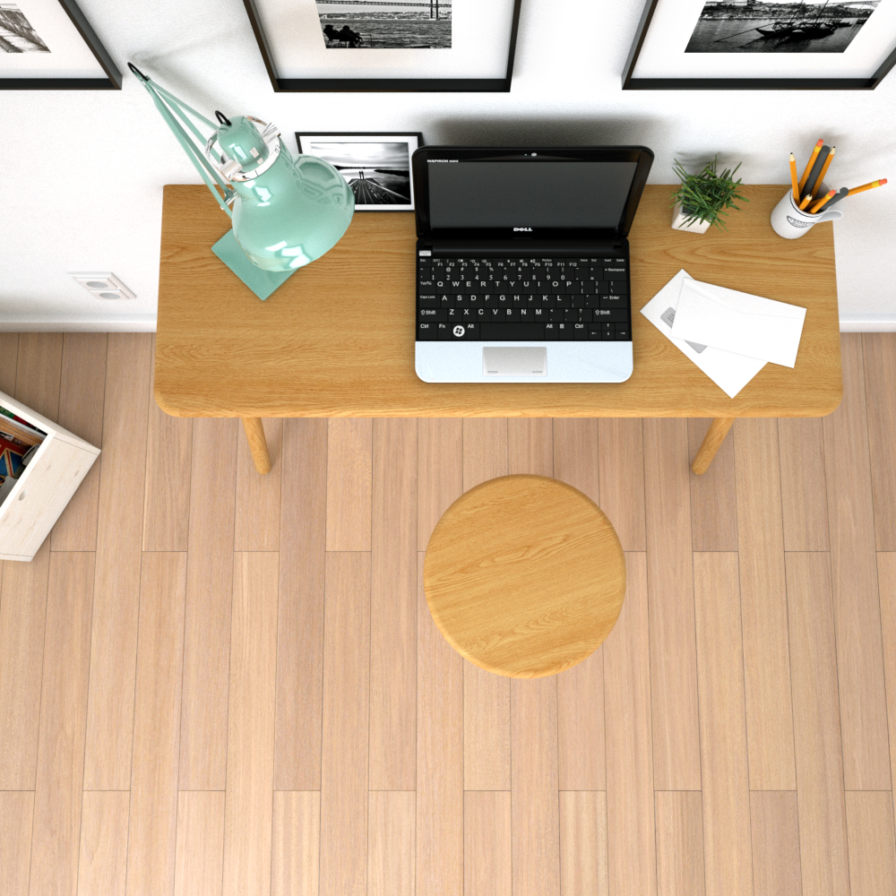

Thanks for all you support and info.
I bought the Octane for SU yesterday and I am happy so far.
Here the first renders I did yesterday, all inside SU I did not export to standalone.
This work flow is new to me and I need some time to get used to it.
It would be great to have the same info as in the standalone version for when the render is running, a estimated time for how long the render will take.
Also, when i close the view port and then open it again, all the view port settings are reset to default, i want it to remember my last settings.
I have the same issue as others and it is that the bump do not have the same strong effect as in the standalone version.
DL DF 1000
Used a AO pass to mix in photoshop at about 10%

Ay sweet as! Nice work!
As for the issues, I'll check the bump and revise the render info. I need to do some redesign in general but do not have enough time for this now.
Cheers!
