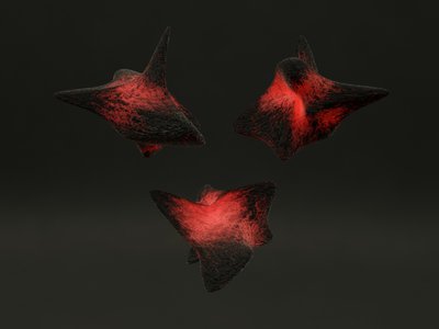

take a look at this thread here http://render.otoy.com/forum/viewtopic.php?f=30&t=40848
pxlntwrk http://render.otoy.com/forum/viewtopic. ... 20#p215041
was so kind to give his version of this awesome shader, based on blastframes rustshader tutorial here http://vimeo.com/100085092
With pxlnetwrk´s shader you can create a lavashader like this (see attached image)
All i did was replacing the metalshader with a red emissionshader and reversed the dirt invert settings.

NICE!!! Exactly what I needed. thanks so much!
