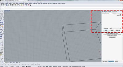

Hi I use my GTX 660M Notebook GPU for Octane and the Standalone is working fine. But my Rhino Plugin does not detect the graphics card or there is a bug with the checkboxes that i can´t select my graphics card for rendering. PLease see attached.

Hi Tobi
Which version of the plugin are you running?
Which NVidia driver version is installed?
What does the Octane Log window say?
Have you authenticated the plugin yet?
32 or 64bit Windows?

Hi Paul,
SOLVED:
it was an outdated driver, and the standalone was also an older version that supported that nvidia driver. Updated the driver and everything brilliant as usual
Thanks for support.
cheers Tobi
SOLVED:
