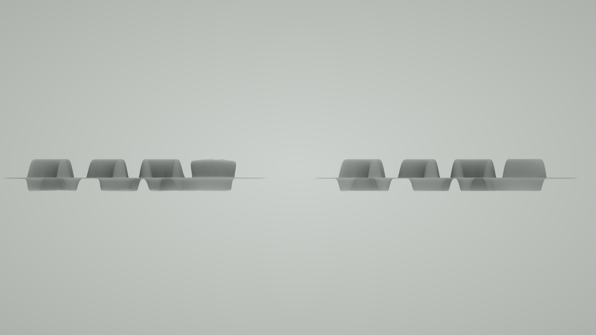

I just setup a very simple scene ,exported from zbrush with negative and positive displacement for anyone that may be interested..I also have added the hi res target OBJ from Zbrush, next to it to compare the result.
Its very basic,so please excuse the crappy model, but i think it shows that correct displacement from Zbrush is not difficult to do in Octane
