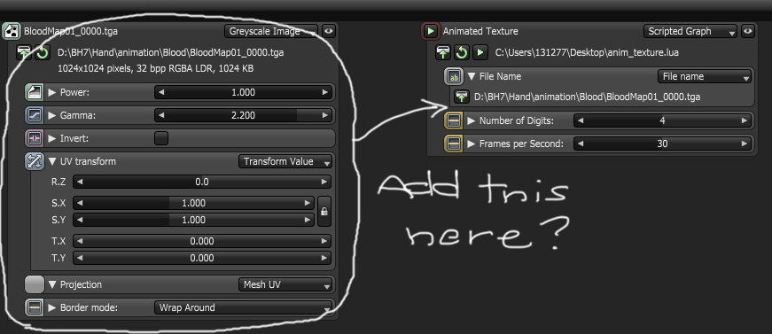

Would it be possible to add the Image options window?
