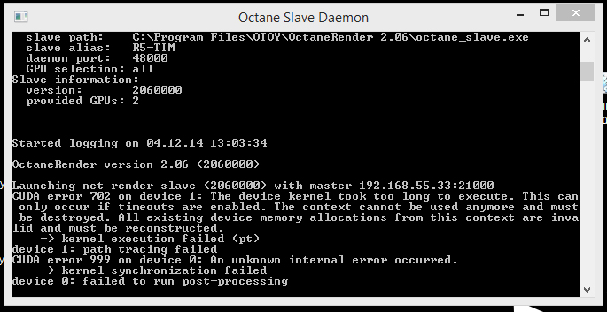

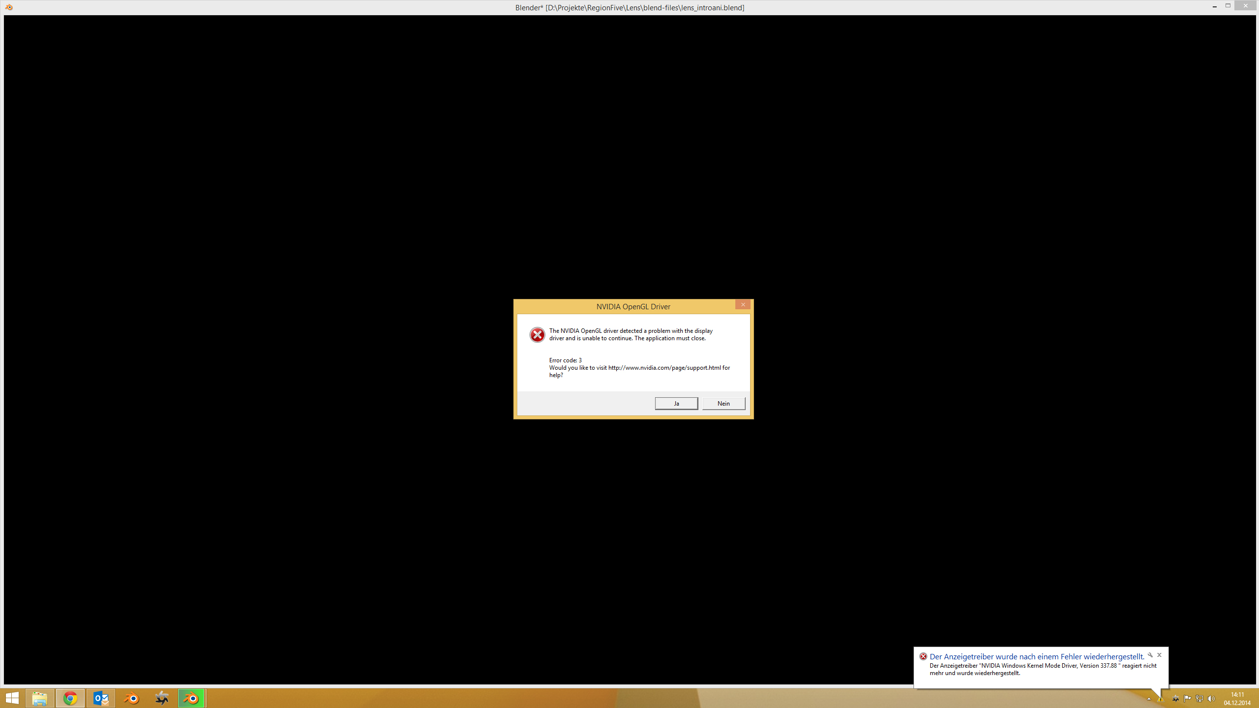

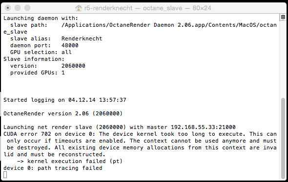

The problem comes when I plug a displacement texture to a mix tex node and start an animation render.
The render starts normally, but after some time the slaves stop working. When the desired amount of samples is almost reached (like 1985/2000),
The render either stops and it keeps going in that state forever or it crashes the display driver on the master machine.

It looks like some issue inside the Octane engine, not in the plugin... I will release the next plugin version (after it will be ready) using the last Octane SDK version, so it could fix this issue...
JimStar
Posts: 3823
Have you installed Octane (standalone and slaves) on all machines using the installer?
Could you please check what values are in "HKEY_LOCAL_MACHINE\SYSTEM\CurrentControlSet\Control\GraphicsDrivers\TdrDelay" registry key?
