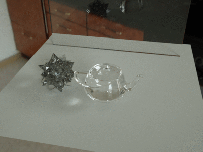

I have a very weird problem with the specular material. As you can see from the attached image, I use a Daylight illumination and applied a simple specular shader to the box and teapot.I use PMC and the shadows are soooo dark! How this is possible? I remeber a day ago my results weren't like this at all. Don't know if I touched anything by error...

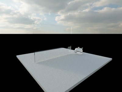

Same simple scene with HDRI.
Something is wrong, the engine is very slow and lot of fireflies appear on the objects! Two dasy ago when I tried it the results were faster and cleaner!

Already encountered this problem, Octane have a very strange behavior with glass, use fake shadow on glass material with alphashadows on, otherwise, noway to resolve light passing through the glass, hope the octane team will work on it.

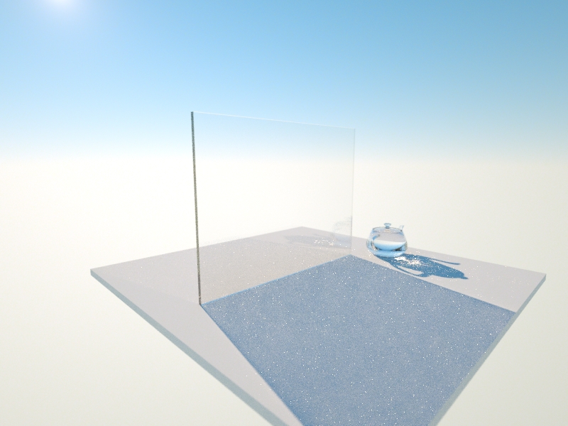

Guys thank you for getting back! I really can't believe that the Daylight rays can get through the glass material at all!!! This is very disappointing!
BUT, as I already mentioned, when I did my first tests three days ago, seemed everything fine and fast! I can clearly see the problem here.I am working on a scene where before the caustics were very fast to compute and now is damn slow and the sun doesn't gets through the glass anymore... Don't know what is happening.

Hi, Dom74 has already told you the solution for this problem: use fake shadow on glass material with alphashadows on((from kernel panel of render settings)Dionisio wrote:Guys thank you for getting back! I really can't believe that the Daylight rays can get through the glass material at all!!! This is very disappointing!

Yes, thank you again but this is not a physically correct solution. Doing the same simulation with Iray for example, the difference is huge!
Can't imagine complex interior scenes where every glass element produces such results.
