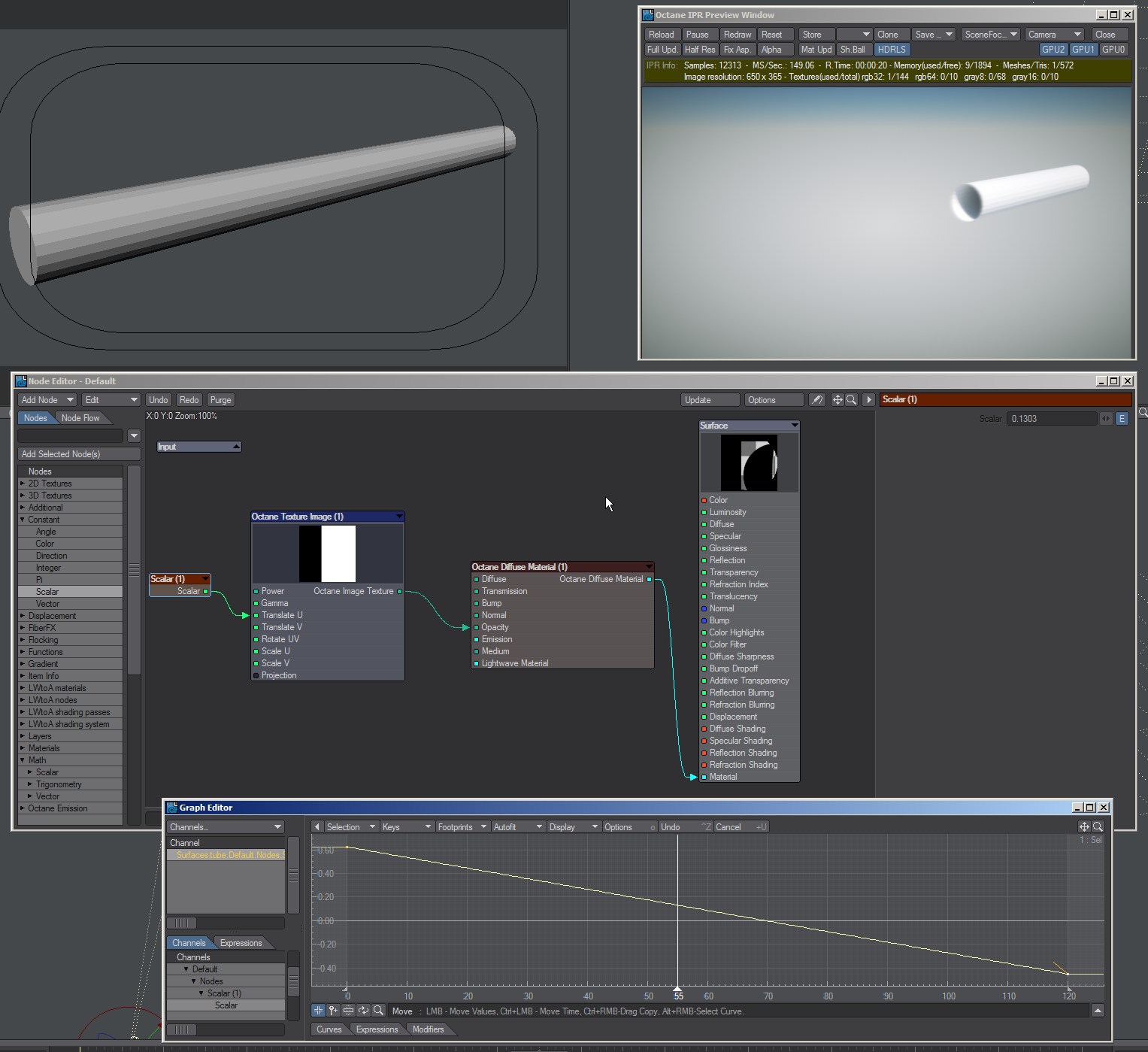

Your best chance to get this effect is to have an UV map in the object along the animation axis, a wipe texture map and animate the "Translate U" image texture parameter. Try the attached scene to see how it works, you only need to scrub to see the effect. Open the object in the modeler to see the UV map, that in this object is only a planar Z projection.
-Juanjo
tube.rar
(7.33 KiB) Downloaded 288 times
