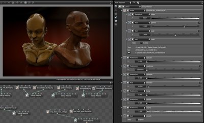

Since purchase I'm playing with my ZBrush scuplts and materials... but I have a little problem with reflections on glossy materials. Can't fully control them. Even with specular value 0. It looks like permament frensel reflections to me.
Is there any possibility to control this effect or take it off completly? Don't want to use roughness value which gives 'satin' effect.
-left, clayish yellow bust

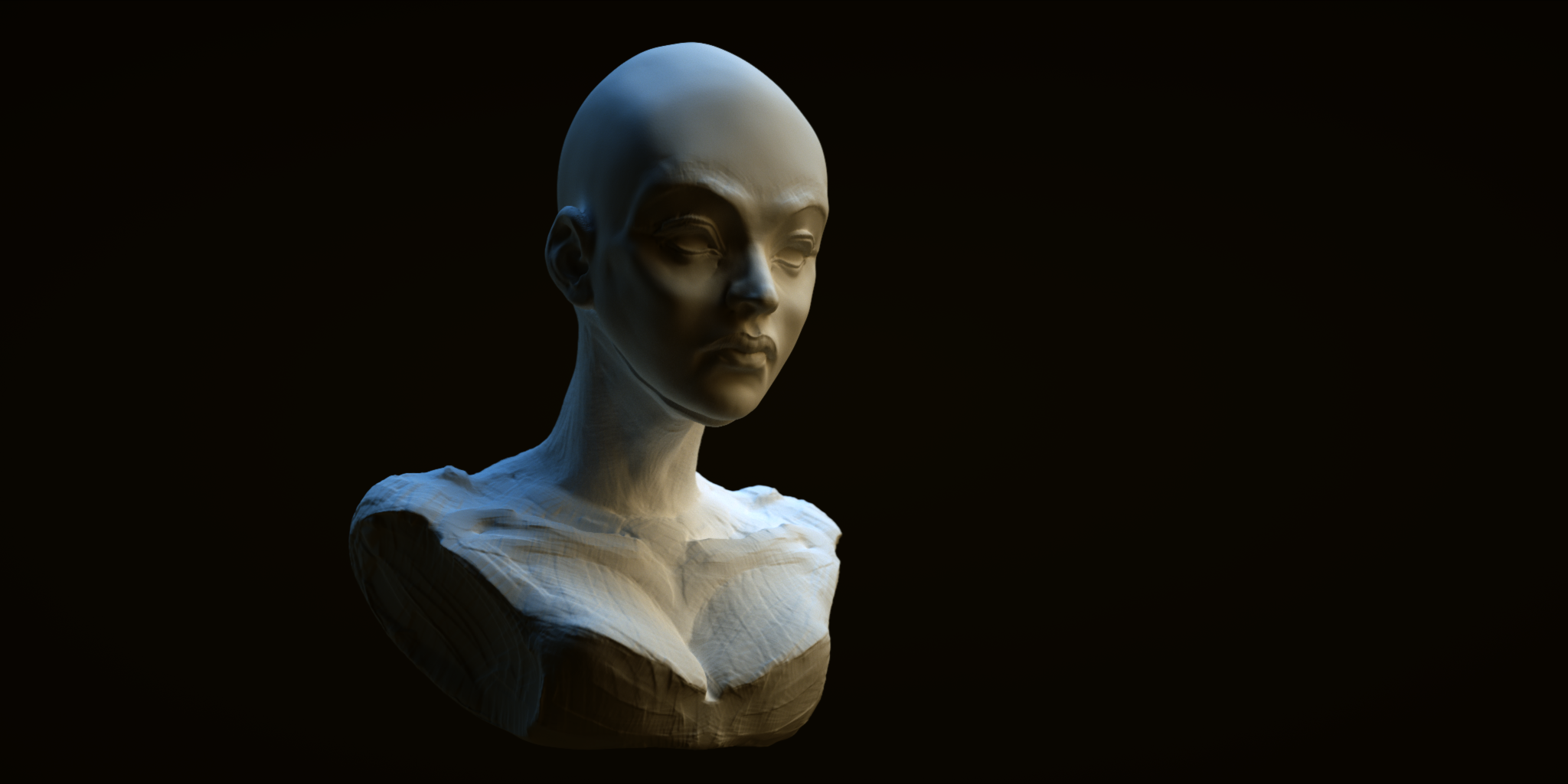

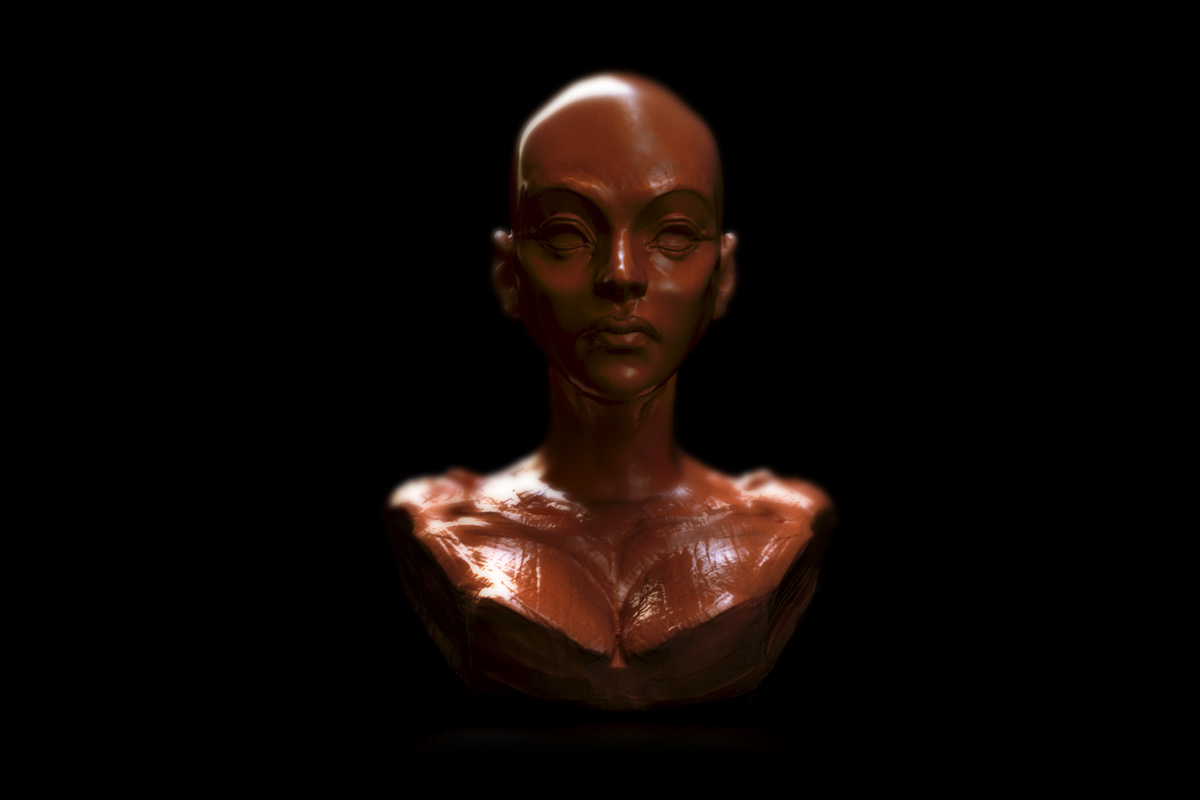

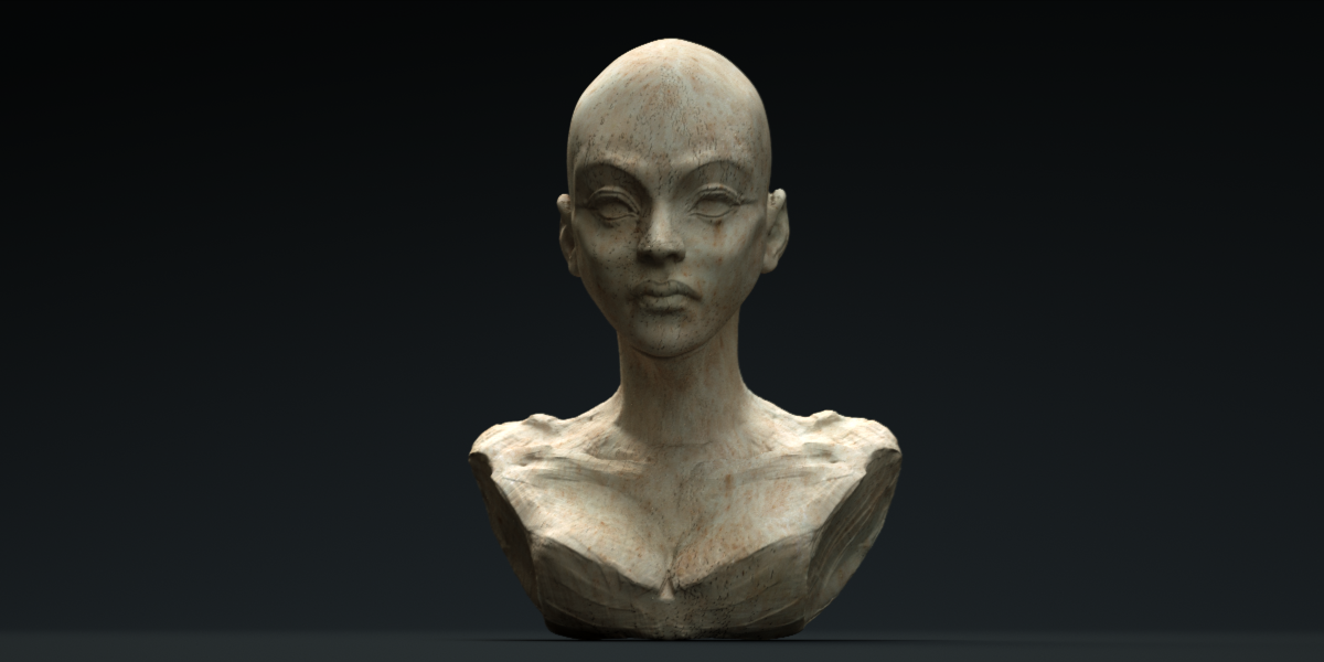

Thanks for reply. I'll be happy to have an option to lower this clearcoat effect, it way to much at this moment. I am currently working on clay-chavant materials, they're a bit reflective but not satinish like roughness gives. Plain materials with additional maps are quite good.
Clay. dof, bloom-PS
Clay. dof, bloom-PS
stone map, bump map
stone map, bump map
plain 90% white
