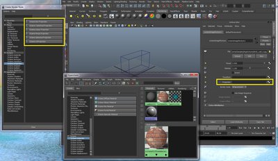

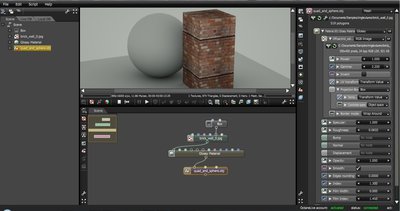

for your query, its something like this:
concepts are based on the standalone:

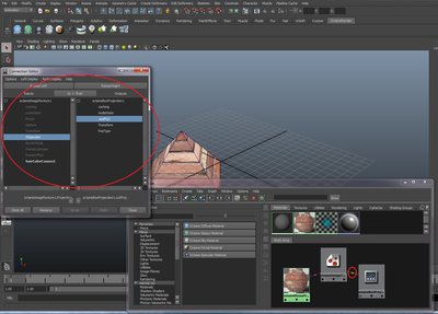

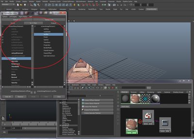

This error means the projection node has been connected to the diffuse attribute of the glossy material.
To correct this, the projection node should be connected to the projection attribute of the image texture instead.
so here's how it should be:
OctaneProjection_outproj -> OctaneImageTexture_Projection
OctaneImageTexture_outTex -> OctaneGlossyMaterial_Diffuse
these concepts are based on the standalone. It will be easier to check with the standalone first as you'll be able to visualize all the pins (node attributes) and what types of nodes can be used for them...
