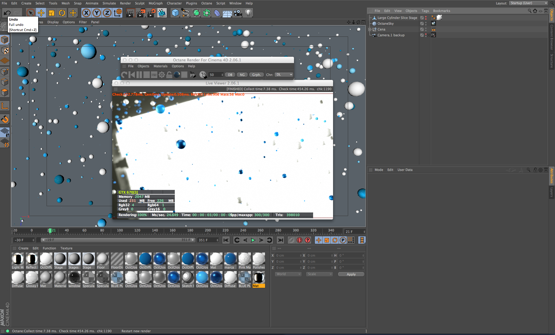

I have a simple question in Cinema 4D + Octane. What should I do to make the OctaneSky with HDRI not seen by camera?
I tried the obvious ways like: Add a Compositing Tag and mark Not Seen By Camera. Add a Octane Object Tag and disable Camera Visibility. Nothing works.
Any ideas?
Thanks so much!
Posts: 16068
Location: Türkiye
Hi, compositing tag is ignoring by plugin, don't waste your time with this. Just click Kernels->keep environment

Thank you Aoktar!
Its exactly what I needed!
