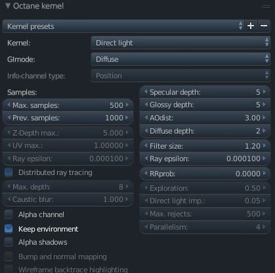

no matter what I try with the kernel settings I always get the same firefly problem in the image:
Kernel:

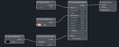

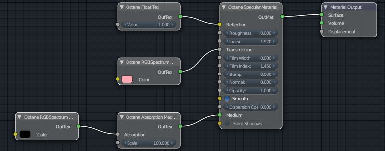

Glass material:

Have you tried to increase the size of your light(s)? This can help with the fireflies. Also lowering the reflection a bit might help?

This scene doesn't look like it would benefit from PMC kernel. I think you could get around this by trying out DL kernel.

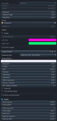

Thanks everyone for the answers. I followed your advices and switched the kernel, lowered pixel removal and tried some more things and this is the result now.
Here my new settings: @grimm: the sun size actually increases the fireflys in this case. now my sun size is at .25 now.
