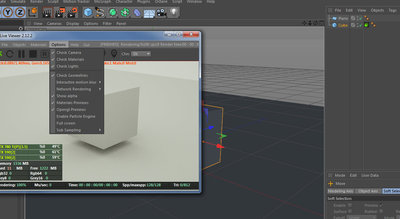

'Start Octane render' IS the send scene/restart command. Did you try it like we suggested?Iceman9 wrote:I'm familiar with adding shortcuts and see how I can add/change keyboard shortcuts to a few of the Octane commands. But the primary command I'm most interested to add...isn't listed. Once again: it's the send scene/restart command.
I might lose interest in that shortcut if livePreviewing worked more reliably.
Despite the fact that geometry updates is selected...it has either never worked. I'm on R16 on Mac.
OK. Thanks!milanm wrote:'Start Octane render' IS the send scene/restart command. Did you try it like we suggested?Iceman9 wrote:I'm familiar with adding shortcuts and see how I can add/change keyboard shortcuts to a few of the Octane commands. But the primary command I'm most interested to add...isn't listed. Once again: it's the send scene/restart command.
And again, make sure it's the latest test version from the second post because file names are same as before.
For geometry updates to work you need to add object tag to an object first and resend scene once. Otherwise it would be a nightmare with more complex scenes, right? Some generators, lights camera etc. update without a tag so i guess that's confusing you.
I checked this video but unfortunately my installation doesn't behave at all like in the video, using the same settings.aoktar wrote:thanks for replies,
i'll check all and going to add a few new commands.
Iceman9,
please watch these videos to see updates how would works
https://vimeo.com/groups/209276/videos/108597468
