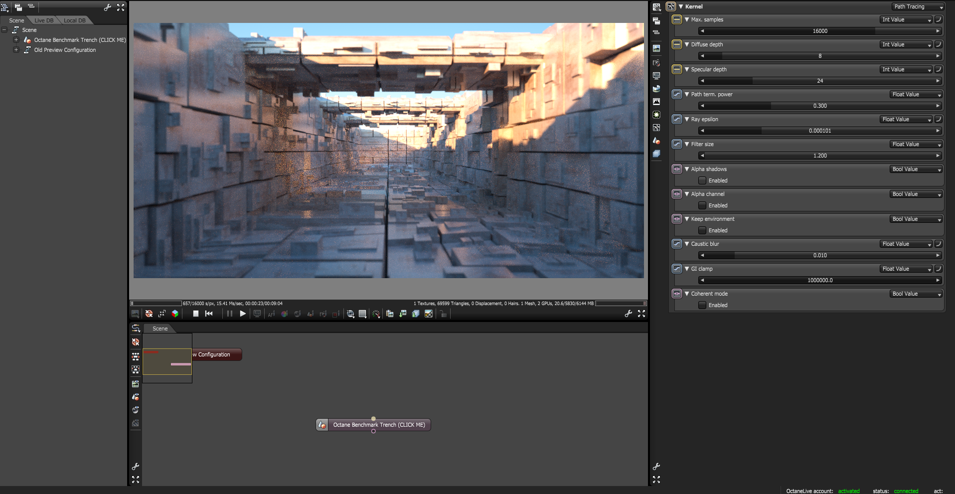

If you have 2 Titan Z in your system you should have 4 Titan GPUs. In which PCI-E slot (8x or 16x) they are shouldn't matter, since we minimized the amount of data that needs to be transferred via the PCI-E bus.
In your last screenshot only 2 GPUs are running. In the Octane preferences make sure that 4 GPUs are enabled. If you see only 2, then something is dodgy with the system. What I usually always do, after installing a new GPU is reinstalling the graphics driver. Version 344.48 should work fine. After rebooting the system, check the NVIDIA control panel and make sure that you can actually see all 4 Titan GPUs there. Then open Octane and check the CUDA device selection. Let us know if there are still only 2 GPUs, but in the NVIDIA control panel are 4.

abstrax wrote:If you have 2 Titan Z in your system you should have 4 Titan GPUs. In which PCI-E slot (8x or 16x) they are shouldn't matter, since we minimized the amount of data that needs to be transferred via the PCI-E bus.
Thanks for the feedback Abstrax :)
In that last screenshot there was only 1 Titan Z installed, I am removing that one now and replacing it with the other to make sure
there are no issues with the cards themselves.
