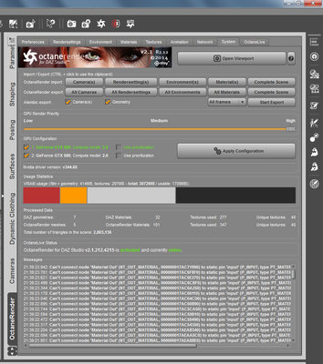

I "Had" to use it because I needed to export the camera.abc files and open them in Octane SA so that I could render some scatter file environments that I then used as a backdrop in AE along with the .png animation that I created with OcDS (mostly from version 1.2, but a handful from v2.1 did work once the geometry issues were solved).

If your workflow involves using camera.abc files, you have to delete all object (except one that is in the scene most of the time) and all other cameras. I usually set up a scene with multiple cameras so that I can have a selection of nice views, but these tend to clash and cause the exporter to honor only one camera (which will most certainly not be the one you want). I'm sure this will get solved over time and there could be another work around that is currently unknown.
