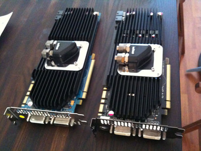

I had 2 gtx285 stacked on top of each other , very classic setup.
It's quite hot these days here so the ambient temp is around 25-28°c inside.
At iddle the top card was at 67°c and the second one at 55°c
During load, both cards were at 84°c.

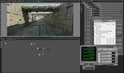

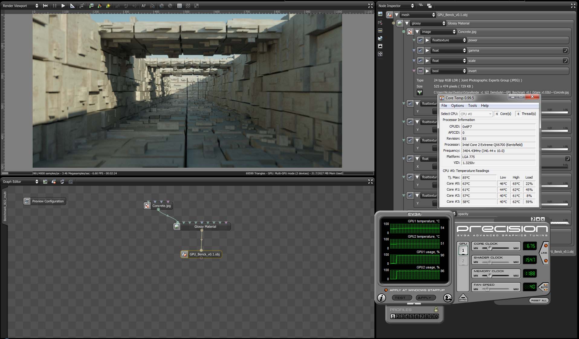

Now that they are watercooled they are both at 47°c idle and ... 52-55°c at full load with Octane.
With only one card rendering, the temp doesn't even bother to go up.
to give you some figures about this setup:again...hardware for octane

How you manage the flow?
From the pump to CPU (if exists) to GPU1 to GPU2 to cooler and back to the pump?
Or use you T-adapters?

Ah ok, thanks.
I have only one radiator(360x360x60) passive for the CPU.
I think it should go with one fermi in line with the CPU, active then...
