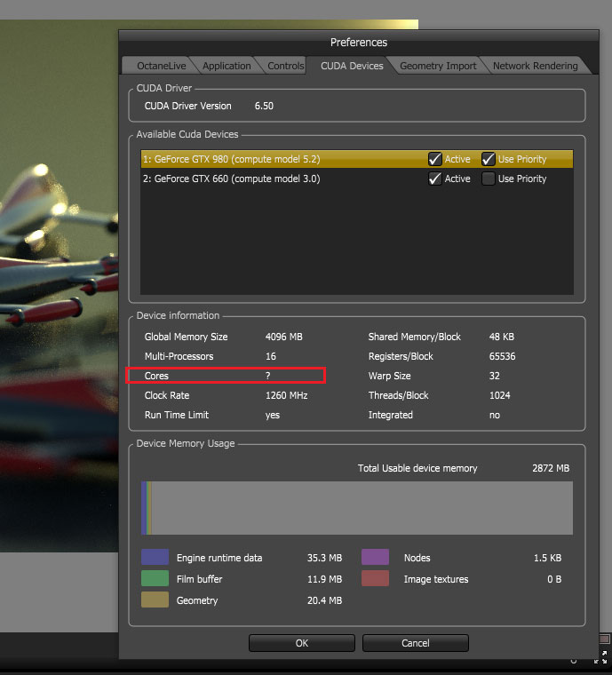

The program does not show how many cores my card GeForce 980GTX (MSI 980GTX 4gb Gaming)
WIN10/I7-5930k/2xRTX2070SUPER
