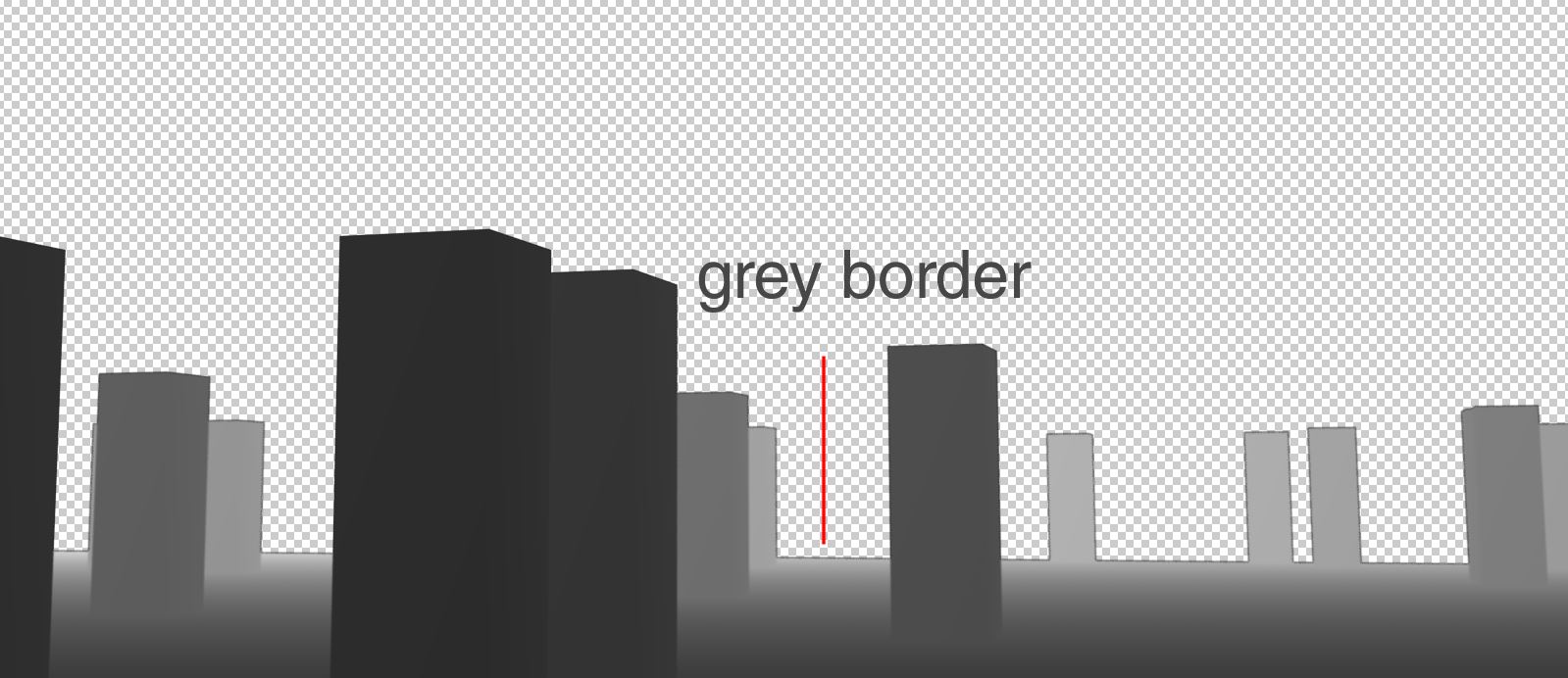

Hi Aoktar!
I want to use the alphachannel for the mainrender image and the multipass files. For the render image the alpha looks fine. But when i apply the alpha for the z-pass, i get grey borders around.
On the camera tag is "premultiplied alpha" checked and in the rendersettings is "keep enviroment" unchecked.
I am working on R15 and the lastest octane version. Have i missed something?
Greetz
Greetz
