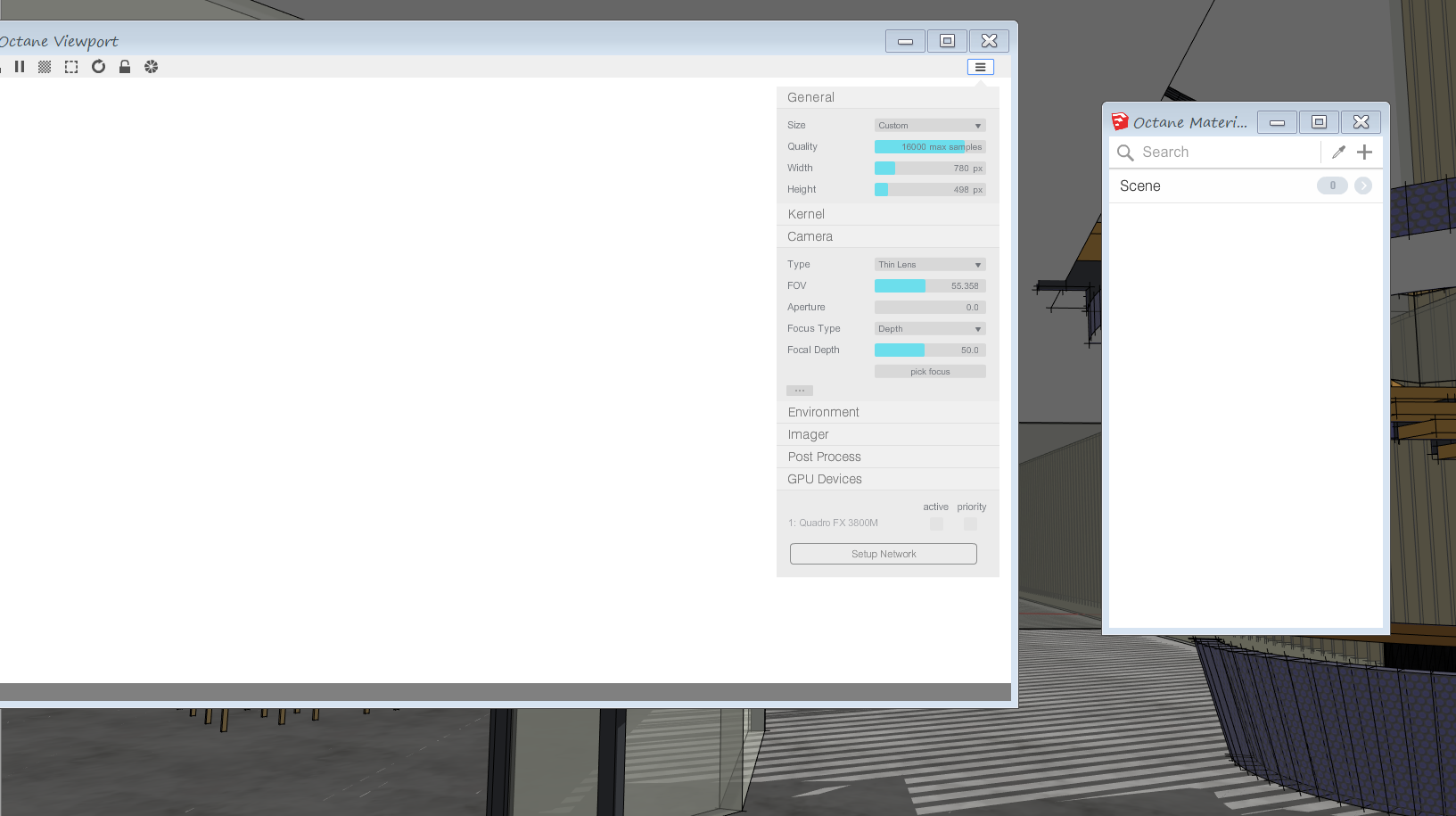

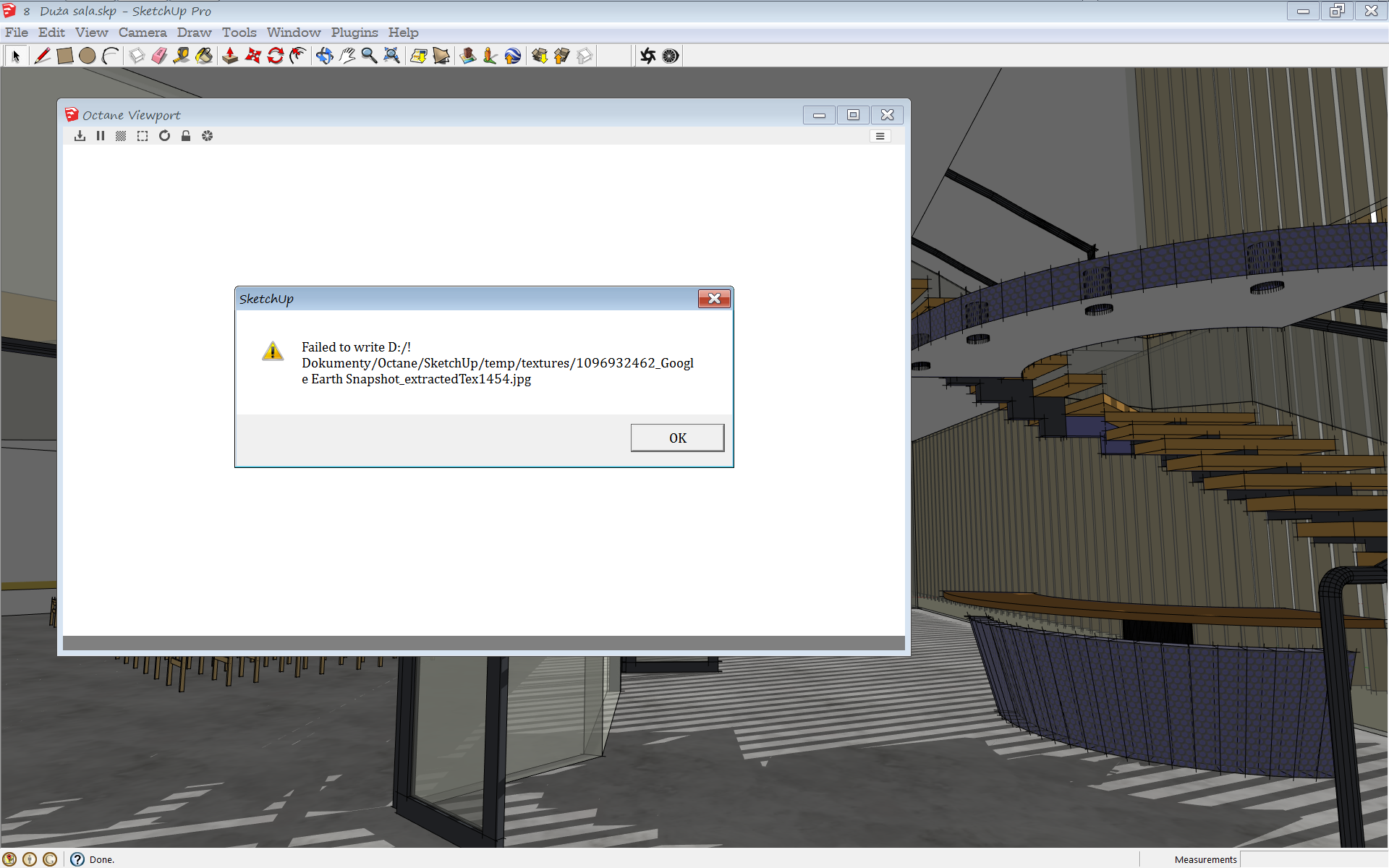

Either in SU 2014 and SU 8 as well.
And as a result nothing happens.
It does open in ArchiCAD, though but not in SU.
My GPU device looks to be grayed out, I know, pretty old card but it is CUDA anyway.
What seems to be a problem?

Octane demo fails to write the textures in Sketchup
Hi Marek,
Unfortunately, you will not be able to run the sketchup plugin on the FX 3800M.
The Sketchup plugin requires compute capability 2.0 or higher (you can check GPU's here: https://developer.nvidia.com/cuda-gpus).
Chris.
