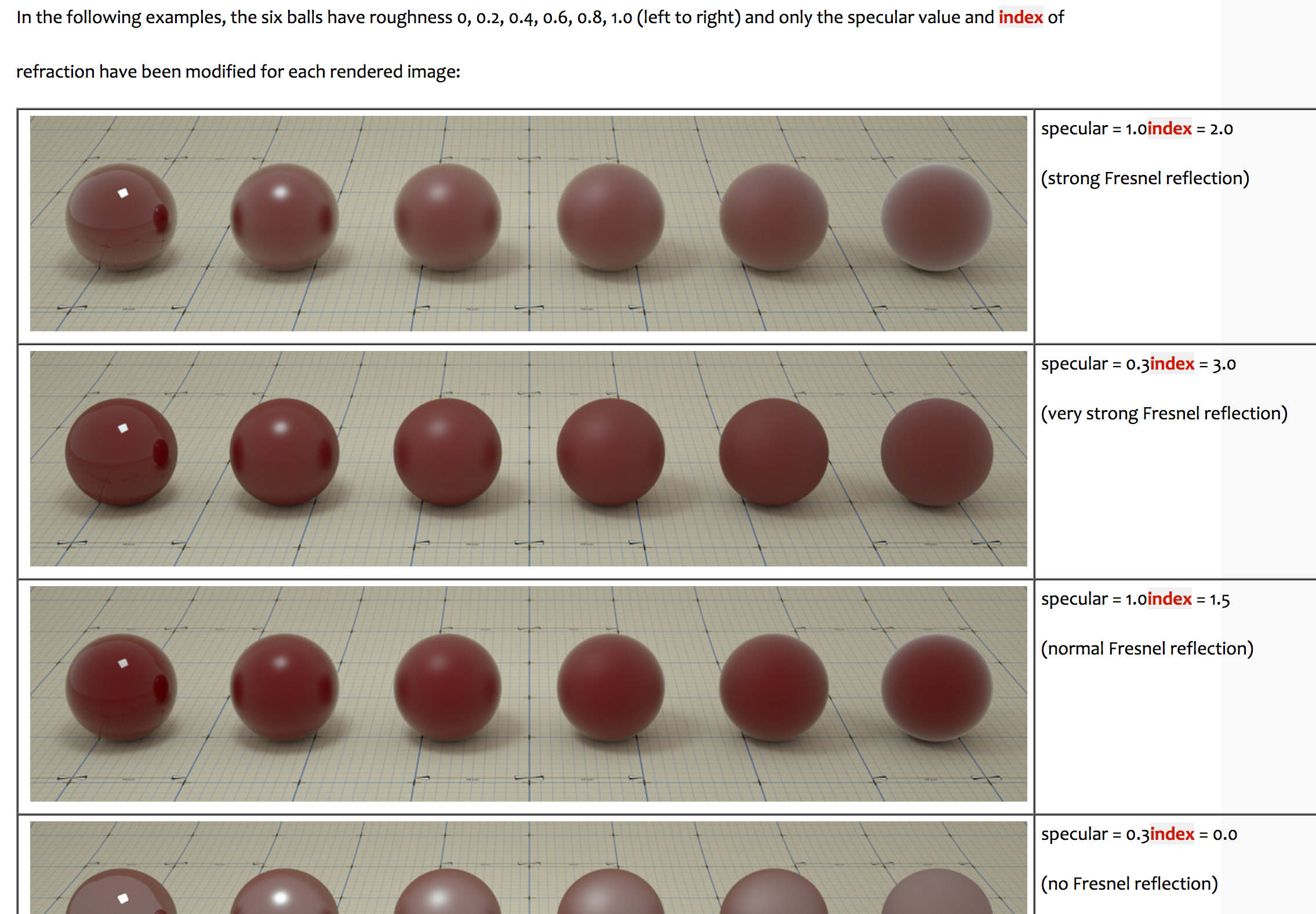

Anyone know where I can find the decimal "specular" setting this manual section is referring to?

you can find them in the respective glossy material channel, only the last row is wrong because you can't set a value for Index below 1.0
I think the correct Index for last row is a default 1.3, if you set Index at 1.0 you obtain a mirror effect like metal chrome
