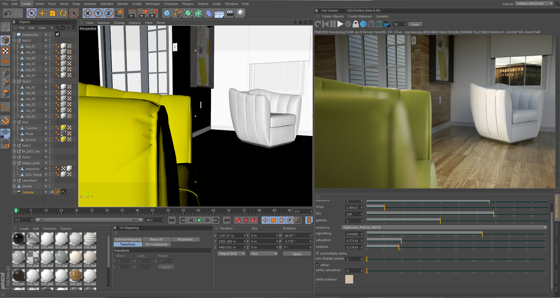

Will attach an image for example
The Floor is black i would like too see texture to map it correctly.

Sorry but your image shows a very old version. What's happening there?

Sorry but it is image for. Reference for example found on internet

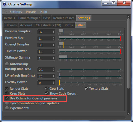

ok, confusing. Please don't forget to add some additional info about version which we are talking. Also to see a screen could be much better! I can only say that you should check octane opengl settings. It should show correctly your textures.

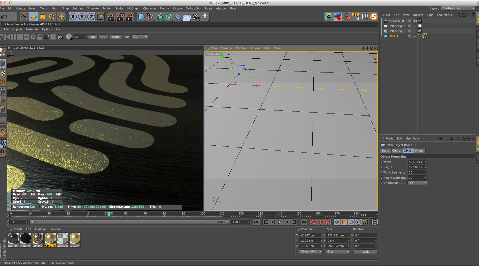

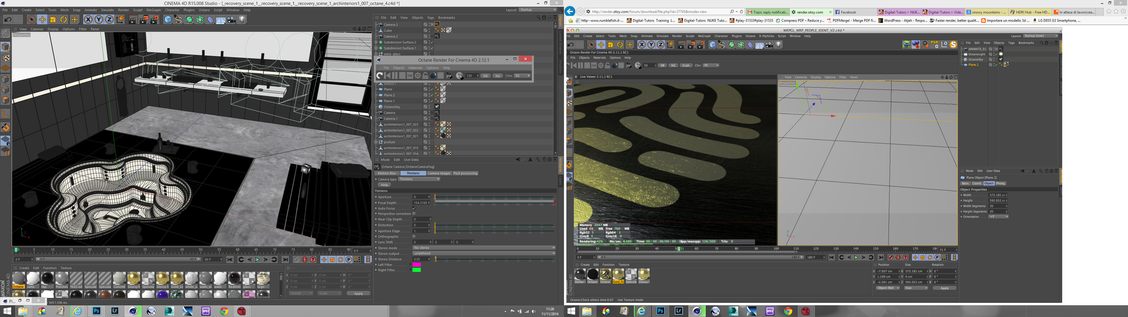

yes i will attach my screenshot like requested
I have last version as you could see my texture in view cinema4d are mostly black only the floor is visible with preview texture.
I do not know where OpenGL settings are for Ocatne
