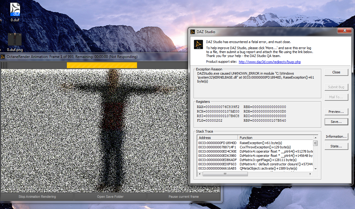

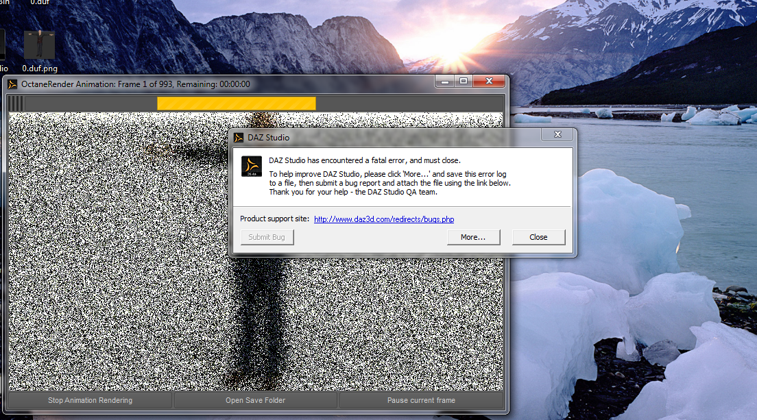

Currently unable to render animation due to Ds crashing every time I hit the 'Render Animation' button from withing the animation tab.
- Attachments
- Scene File.rar
- Scene File...
- (580.17 KiB) Downloaded 221 times
- Log files.rar
- Log Files...
- (11.37 KiB) Downloaded 185 times

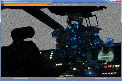

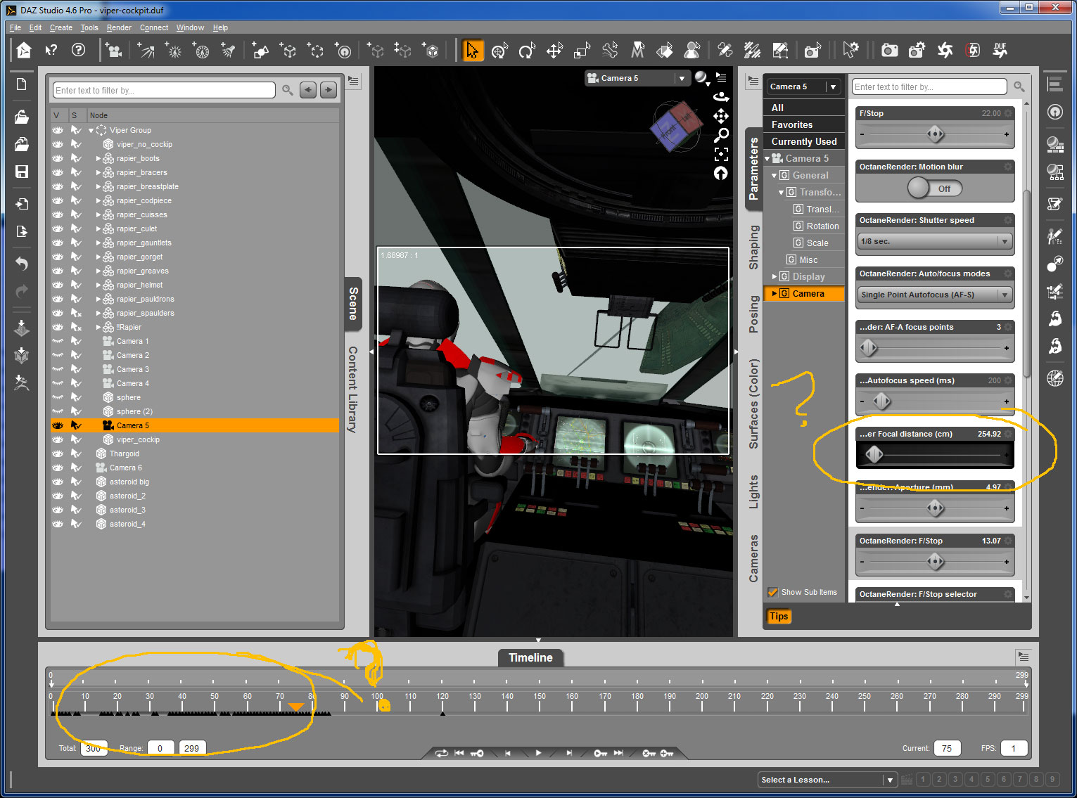

I'm sure you have your hands full with a huge list of bugs. However, this one I found to be a set-back. It started with the geometry shifting away from where it should have been, so I went to downgrade back to version 1.2. To my surprise, Daz crashes immediately upon opening up the file I was working on with version 2.1.
What this means is that BEFORE you install the new version, make a COPY of your .duf file and label it v1 or v2 so that you can downgrade without losing your work. Opening a file and saving it as-is will make it incompatible.
Notice here the armor shifted away from the person (who's still sitting in the chair).
It also crashed immediately, but that is to be expected from test product.
Notice the additional keyframes that are generated out of the blue when scrubbing the timeline.
Also the focal distance slider is black (could be intentional, or a side affect).
Good Luck
Good Luck

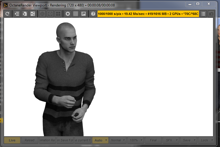

I get tons of "can't connect" messages and a couple models with their position shifted as well ( props, hair for now ).
