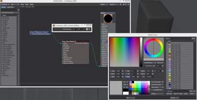

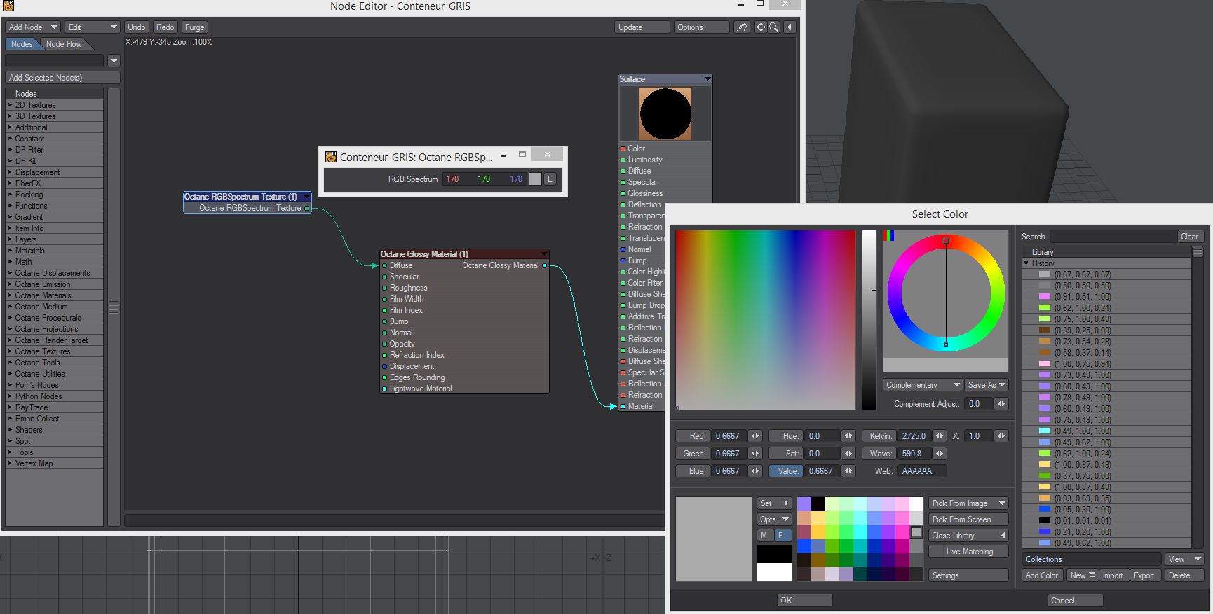

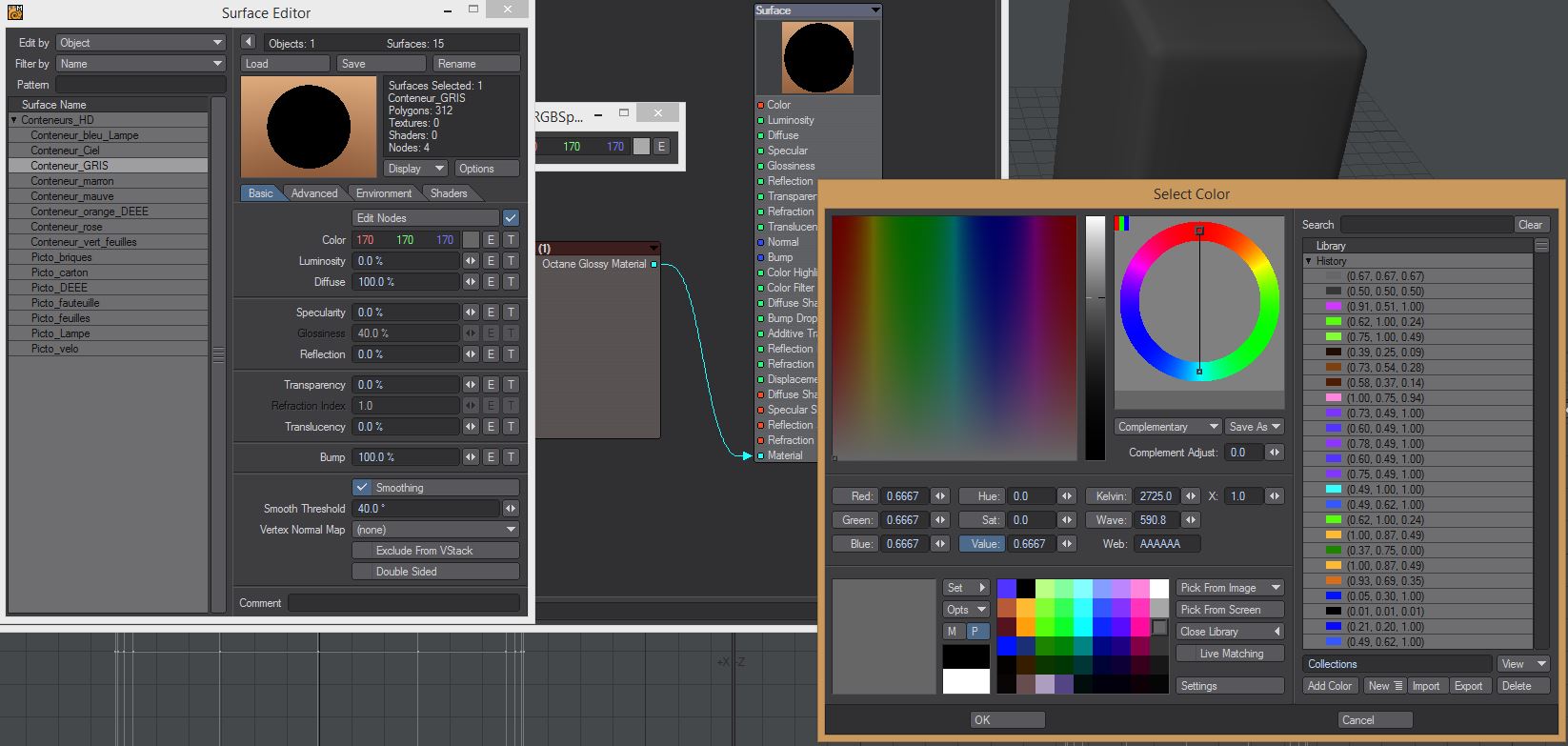

is there someone to tell me how i can choose the same value color between octane palet color and lightwave color palet
for me the value is the same but i see a diferent result over my monitor between the octane rgb node and the lightwave color

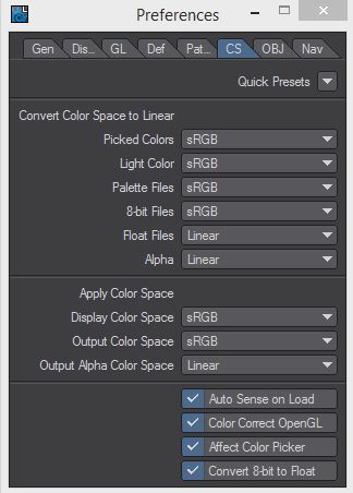

and i put every possibles options in the preferences panal of lightwave
Please help me to understand why is different and maybe how to put all fine for any situation

All the color LW color settings should be set as Linear, with all options disabled.
But the problem can be that the LW color picker can't be corrected with the Octane film response settings, so if you don't work in linear mode, the color you pick could not match the color you get in the rendering.
