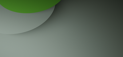

valters wrote:My steps was simple, I have just render two images, one with single gpu and second with both gpus. Both renders with the same amount of samples. After this just switching fast between two images I can see that block thing. Can you upload two rendered images, one with single card and second with two gpus and Pri. on?
The first image was rendered on a Titan:
... and the second on a 690 and a Titan:

I have got the same issue - i think. I will post tomorrow my screenshots. It look like a block which is noise free. But the rest of the picture has a lot of noise.

Pixelkingdom wrote:I have got the same issue - i think. I will post tomorrow my screenshots. It look like a block which is noise free. But the rest of the picture has a lot of noise.
ok, i applied "different matte" in AE. When i subtract priority image from non-priority, i can see a rectangle. But no rectangle between priority-to-priopriy or nopri-to-nopri. Also i'll compare with 1000's maxsamples.
EDIT:
Hi, we can reproduce that here. There is a problem when "render priority" is active. I hope that's easily fixable.

valters wrote:nvidia driver: 344.16
gpu1: GTX 680
gpu2: GTX 760
OS: Windows 7 Pro x64
C4D: R15
octanePlugin: Version 2.12.1 - final (updated on 28.10.14)
p.s. added files:
after restart+new scene. DL kernel. + Difference Matte to see difference
+ one 4000x720 Difference Matte and pixels count
Ok, the problem will be fixed with the next Octane version. Thanks for finding the bug.

It's just me or this update isn't showing the Render Stats and Keep Stats isn't work on R16 for the Live View?
I'm also noticing a small offset on textures used for a Background Object and the actual rendered image, also in R16. I didn't noticed none of these issues with the previous version in R15.

pBarrelas wrote:It's just me or this update isn't showing the Render Stats and Keep Stats isn't work on R16 for the Live View?
there is not different since several versions for background object. Can you check again and if there is really problem please post a few images to show that. Also i have checked stats on R16, it's looking as ok.

In R15 I can get the Render Stats in R15 :
In R16 I can't get any Render Stats:
Here's the offset problem I was refering to:
