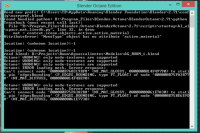

Sometimes, when i add a LiveDB material to my scene, the viewport render doesn't work and i get a message saying> ERROR! Check console for detailed error messages.
Console says this> (see image)
My mesh is UV unwrapped properly and sometimes the exact same material works and sometimes it doesn't.
The only way to get rid of this error is to restart Blender even if I delete the LiveDB material form the scene.

What version of the plugin are you using?

Thanks for answering I´m using version 2.06 6.0 (2.71.5) 64 bits

TheBurnsWalker wrote:Thanks for answering I´m using version 2.06 6.0 (2.71.5) 64 bits
This bug has been fixed long time ago. Use the last 6.4 version please: http://render.otoy.com/forum/viewtopic.php?f=32&t=43106

Thanks, it works fine now!
