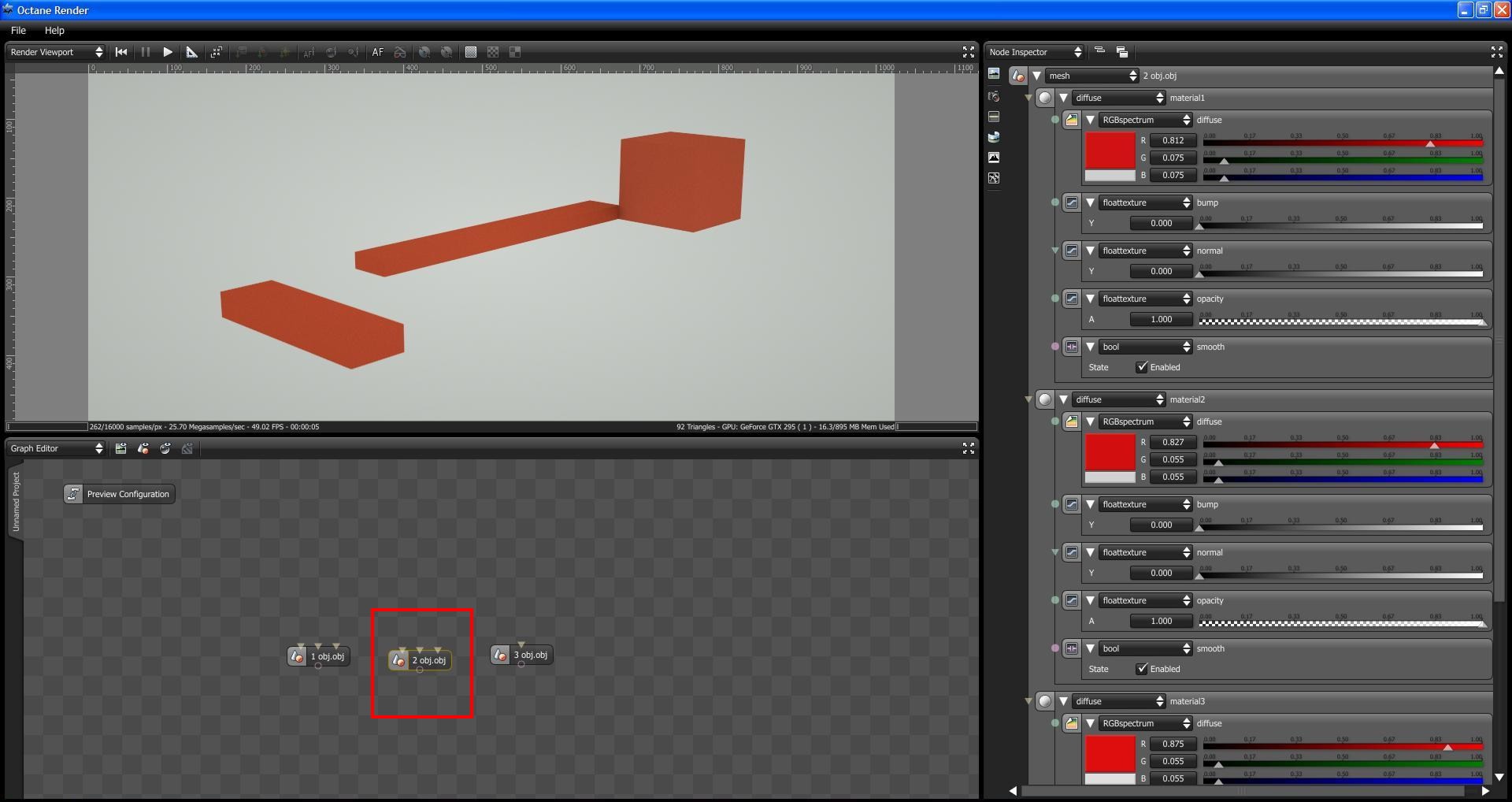

I have tested your set up, but how can you export each layer with its objects in Octane with Rhino?Do you do this operation one at a time with the layers or all together?Because I have seen your screenshot...
I have done one test with 3 layers and some solids on a plane:if I export the layers one at a time in Octane at the end I haven't the solids all together...like in the picture 1. If I export from Rhino to Octane the solids all together I have like in the picture 2...but without no layers!
How do you do with this problem?
Thanks again ;)

I don´t know very well how octane works with layers,I simply export the entire scene with all the layers ,but it seems that no matter,and my scene shows like you a hundred chanels for nodes with repetitive materials ,and I don´t know why? I separate one object or group of objects and put it into independent layer ,but when I export to octane it shows me a lot of triangles for nodes...
I wish radiance can help me with this problem ..
If your answer is if we can put diferents objects in the same scene and you will show all in the same visalization,you may wait for beta 3 ,it is a parameter of future beta..

I'm no rhino user so i can't help with it.
maybe ask on the rhino forums how to propperly configure your export so it exports unique materials for each rhino material...
