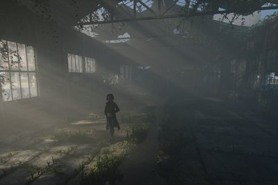

Well, there certainly are some issues, but overall it's working pretty well for me. Managed to get a first complete scene done, with fog and all. Lot's of neat additions everywhere, need to do some more exploring.
Thanks for the update!
Ciao
TD
First complete scene render with OcDS 2.1.

thd777 wrote:Managed to get a first complete scene done, with fog and all.
TD
Could you share the steps required to set up the fog please? I've never been able to get it working.
thd777
Posts: 19
Joined: Sun May 18, 2014 6:25 pm
TD
Sure. First set up the scene as desired. Then add a DS primitive. In my scene above I used a cube of about 50 m length for each side. Position it so that it encompasses all of the scene that you want in the fog but keep the camera OUTSIDE of it! Now apply a fog material to the primitive and render. I used the "Octane Fog" version 1 from the Live DB for the scene above. You need to use the PMC kernel (Path tracing works too I think?) and you need to up the number of max samples ( I used 6000 for the image above, ~5000 would probably have been enough).
Hope that Helps
Ciao
TD

thd777 wrote: Sure. First set up the scene as desired....
Thanks!
