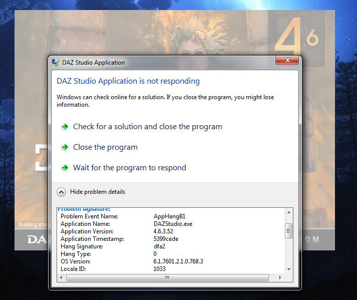

Why does Daz Studio fail to start after the update has been installed, it simply crahses?
The 1.2 version works before the update is applied.

I had this problem. What worked for me was the following: I downloaded the full installer, installed it, activated it, and the downloaded the upgrade installer and installed that one. After that it's working now. Maybe that works for you, too?hjortby wrote:Galatea wrote:Why does Daz Studio fail to start after the update has been installed, it simply crahses?
I have the same issue. Daz hangs at startup (Building interface...)

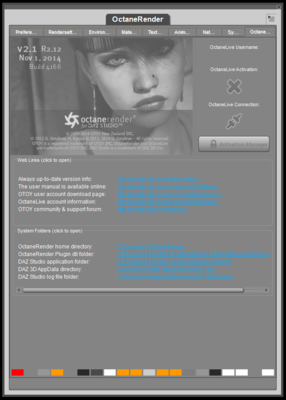

ok, a couple of points:
- 1st i removed the link to the _preview_ installer from oct,2 from the 1st post - it was only meant to have a full installer at hand with all 3 valid versions; it needs half a day to prepare this full installer, so i can't do that for every update. the v15_v21 updater is meant to install the latest version and nothing else... currently on hold!
pls make sure you have installed this file in case of problems. the info image in the OctaneLive tab of the main plugin pane now shows the full & correct version and also the build nbr.; also the small banners on top of every tab are showing correct version numbers (since they are now imprinted programmatically).
- there was a problem with the
- apparently there is a problem with switching uv sets on genesis 2 (or maybe also gen 1) based figures. this might explain several problems during content load. going to address that now and expect to have a fix within a day.
- i'm going to address a few other problems posted here via pm, because they need specific research.
debug.log
in %homepath%\OctaneRender
it could grow quite big, so i added a truncate function that runs during studio startup. apparently this could lead either to delay the startup for a very long time, or even crash studio, if that file was extremely big. i'm going to add a method to the installer/updater that removes that file to avoid such problems for the future.- apparently there is a problem with switching uv sets on genesis 2 (or maybe also gen 1) based figures. this might explain several problems during content load. going to address that now and expect to have a fix within a day.

i did that months ago3dmania wrote:You need to purchase the 2.0 upgrade.gaazsi wrote:i also get the message
I get a message : "this plugin account is not valid for version 2.x"
everything up to date... octane standalone and daz studio
any workarounds for this? in daz studio plugins it shows up greenish but no live activation or connection
installed the latest (...15_v21.exe) and using 2.117 of DAZ Studio (copied folder) - this won't show anything valid (see pic). The standalone Octane EXE shows activated.
EDIT!!!: I got it working. Really odd. (Leaving this here for others)...
I had to run the old Daz/plugin/etc - where it said I was deactivated. Clicked the 'Activation Manager' and filled in the info from the website (reg/password). I had to restart the old Daz for it to 'really' activate. Then I could run the newly copied folder with the new Daz plugin for it to get it.
