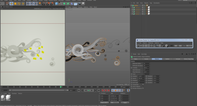

When using particles (standerd emitter) Octane creates some strange spheres. Why is that so? Screen shot attached sphere marked by yellow.
Posts: 16066
Location: Türkiye
Alexzander403 wrote:When using particles (standerd emitter) Octane creates some strange spheres. Why is that so? Screen shot attached sphere marked by yellow.
hi,
it's a result of particle engine implementation. you can disable it by "Octane->Options->enable particle engine" menu

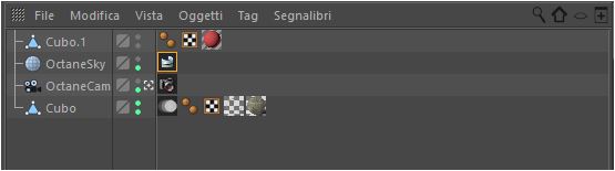

I have a question about user manual, why you don't update the new functionalities with exaustive explanations so the users don't lose time to try how they works? and consequently post several questions on the forum?
For example it was hard for me to understand why "Edit in Standalone" apparently doesn't it works. I have discovered after several failed attempts that it doesn't respond correctly if you haven't opened LV before!
For example on C4D I have 2 cubes, three materials, one HDR image and a Camera.
In Standalone the exported file have several nodes. much more than needed. Why? (sse the images)
I have encountered a problem with very complex C4D scene when I tried to export in Standalone. The numeber of nodes was so high that it was difficult to browse

C4D objects
C4D objects
nodes in Standalone
nodes in Standalone

Hi augdalmo,
thanks for questions. This causes to me write some explanations. I remember that i mentioned about structure and internal workflow as much as possible.
First which document which are you reading? I have prepared a Interactive Help Window. It's better for users. But as you can or should figure that, plugin development is very much time consuming process.
Sometimes i'm working 7/24. Still time is not enough to do everythings. And current plugin structure is big and complex as a standalone software. Every plugin developper is responsible to improve manuals, samples, forum support, etc.... And plugin is updated continously. So it's very hard to keep updated and contains every topics. When we can enter a stabile state on development, i would do a big revision of documentation.
Second, you should send your scene to engine, to be able transfer current scene. This is workflow of octane.
For structure
Let's check the image to see what's happening.
There is a "maingroup" with several inputs. This is our secret weapon for immediately geometry updates.
Inputs are connected as below:
0 -> arealights, 1 -> static meshes(without objecttag), 2-9 -> movable meshes(objecttag nr:0-7), others for RenderInstances, particle engine and hair geometry.
This structure is static because of performance and stability. Also if you see the "cube" node that's connected a "scatter". This is movable mesh. This can be connected also objectlayermap, if you set opacity, camera vis., etc...
Scatter, objectlayer, etc nodes are required for mblur, movable geometry, objectid, and some texture projection types.
This all structure is not designed for readibility of users. All purpose is to provide the fastest interactivity and stability. Be sure it's on best form which is possible. Standalone editing is not our target. User should be able to do everything in C4D.
It's possible to do a tidy nodegraph organisation, but this is very big change on structure and i'm not agree to do. This can causes many issues on stability. I'm one mile away from any advice which can cause problems.
can you explain better this:
"A last question, is possible for you to uniforming the terminology on the plug-in and on Standalone?"
what's different?
I hope that my answers are enough for you,
