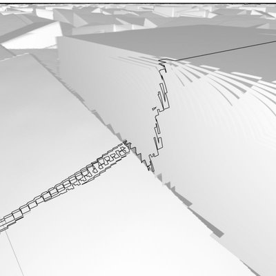

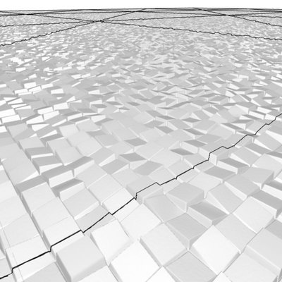

mbetke wrote: Also, if I change displacement values in material editor while having open the interactive window it takes around 10-15 seconds until it updates. I can live with it but is it intended? Seems the CPU is pretty busy while doing the displacement calculations?
displacement generates geometry at render time (that you don't have in your viewport). the gpu's need that raw geometry. so altering your settings will result in recalculating and reuploading the geometry to the gpu's I guess.
alternative (for speed improvement and/or gpu memory lowering): normal bump or bump. especially with normal bump you can achieve great results. but I guess you know that :)
I tried wireframe info channel on a test scene with displacement. it's kind of interesting. it shows the wires of the plane.
not sure anymore about what I just said... maybe karba can explain it better.
edit: ok now i can see the mesh:

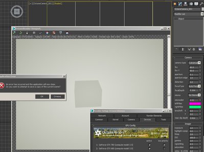

3ds max crash, occurs every time, when I open octane viewport and octane camera tipe put to cylindrical. :(

I have the same problem as mikinik

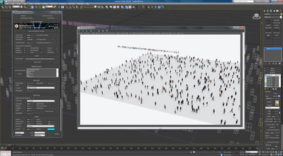

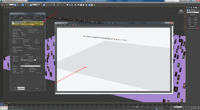

HEEEEEEELP!!!!
Forest Pack pro bug!!!
I need this feature enabled again because I have to complete an important work. Please!
See the attached images. With the 1.18 release scattered people (cardboards) are render fine. With 2.11.1a I have no output (forest pack).
Also if I try to flat the geometry with forest tools (utilities) all cardboards are rendered black!
No problem with 3d trees, they are render correctly.
thank you.
edit:
I found a workaround. If I apply a shell modifier the cardboards they are rendered. Single sheet geometries aren't rendered by Octane 2.11.1a within Forest Pack Pro.
