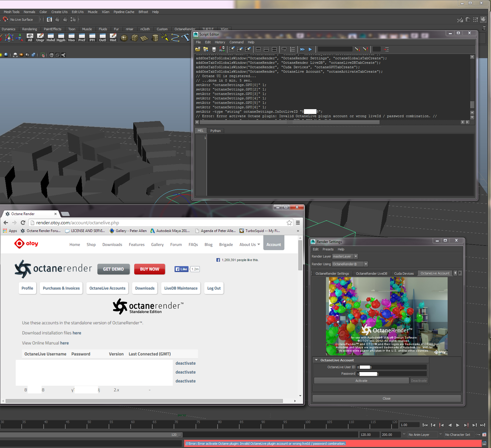

I need to see the content of SE after you entered the ID and password and pressed the button.
p3taoctane
Posts: 1418
Joined: Mon Jan 25, 2010 12:53 am
I have bleeped out the actual ID and password
If you need a PM let me know
I am running V2.10 stand alone and the maya plaugin v2.10 release as far as I can tell
I can try doing an upgrade to v2.11.1 -5.4 and Standalone 2.11.1 if you think that may help??
// OctaneRender v. 2.10 - 5.0
// Octane data types are registered...
// Octane nodes are registered...
// Octane settings store is registered...
// Octane settings instance is created...
// Octane camera is registered...
// Octane tool shelf commands are registered...
// Octane scene translator is registered...
// Octane alembic translator is registered...
// Starting Octane engine...
// Error: Error activate Octane engine: Invalid OctaneLive plugin account or wrong liveId / password combination. //
updateRendererUI;
// Octane UI is registered...
// ...done in 0 min. 5 sec.
// Warning: file: C:/Program Files/Autodesk/Maya2015/scripts/startup/autoLoadPlugin.mel line 46: Loading plug-in "OctanePlugin" has resulted in changes to the scene that may need to be saved. //
// AbcImport v1.0 using Alembic 1.5.4 (built May 8 2014 13:47:10)
updateRendererUI;
addOneTabToGlobalsWindow("mayaVector", "Common", "createMayaSoftwareCommonGlobalsTab");
addOneTabToGlobalsWindow("mayaVector", "Maya Vector", "createVectorGlobalsTab");
setAttr "octaneSettings.GPU[0]" 1;
setAttr "octaneSettings.GPU[2]" 1;
setAttr "octaneSettings.GPU[3]" 1;
setAttr "octaneSettings.GPU[4]" 1;
setAttr "octaneSettings.GPU[5]" 1;
setAttr "octaneSettings.GPU[6]" 1;
setAttr -type "string" octaneSettings.InOctLiveID "8........8";
setAttr -type "string" octaneSettings.InOctLivePWD "y.........j";
// Error: Error activate Octane plugin: Invalid OctaneLive plugin account or wrong liveId / password combination. //
