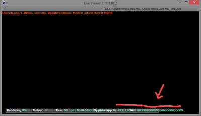

eyeonestudio wrote:In LV
Start LV with empty scene
Triangle info error....
yes i see, thanks
