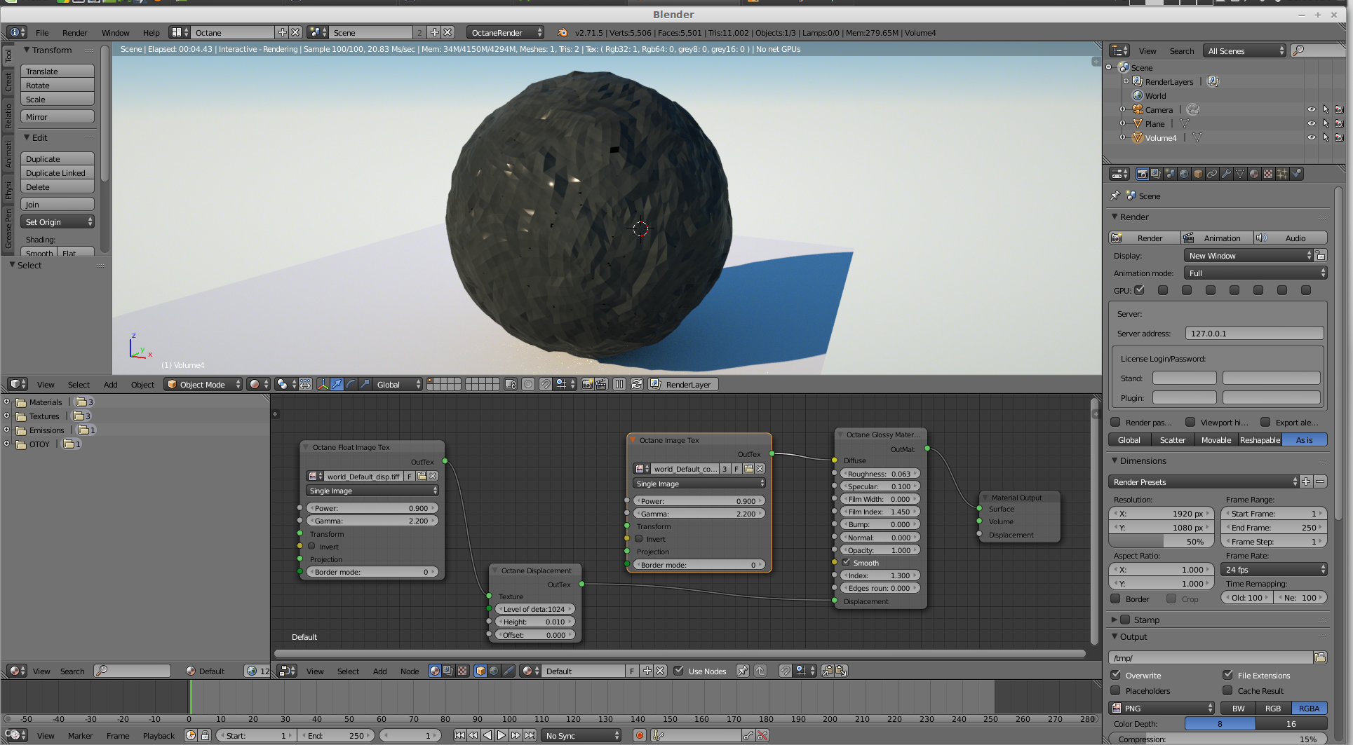

Displacement doesn't appear to work.  Here is something I'm working on in 3d-Coat.  Here is what it looks like in 3D-Coat:
And here is what it looks like in the Octane Blender plugin:
I tested both the 460 and 980 with the same results.  I played around with the displacement settings but they didn't appear to make any difference.  I'm assuming that the level of detail should be set the same as for standalone, ie: in powers of 2 (256, 512, 1024, ...)?  Am I setting up the displacement incorrectly?  Also notice that the diffuse color gets removed when you plugin a displacement.  Thanks,

						Ok I found my problem with displacement, but there are still issues.  The level of detail doesn't appear to do anything.  Here is what I'm getting now.
