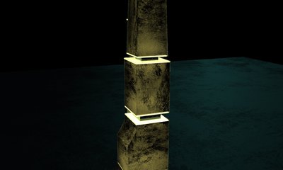

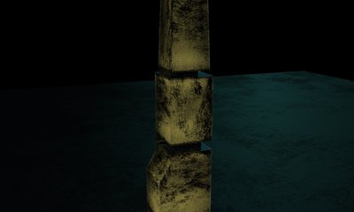

I've opted for objects / emission materials as my light source now. And I thought I'd solved all my problems - I thought I'd keyframe the 'visible in renderer' in cinema 4d to achieve the flickering on for the lights I mentioned.
It didn't seem to work, however, so I thought I'd try putting octane tags on the lights, and whilst this gave better results, it didn't stop the light emitting from the object 100%. So I was wondering if there's a keyframe-able way in octane to completely make an object disappear?
I've attached images of
1) The lights completely off in renderer. (done in the 'basic' tab in cinema 4d)
2) the lights off USING an octane tag with the General Visibility set to 0, but still emitting some light
3) The lights on 100% (camera visibility set to 1 in tag)
I would really like to find a solution where the keyframes are on something in the attribute manager, and not the material itself, so I can use the time offset parameter in a mograph deformer.
Would appreciate any help!

keyframing the 'visible in render' attribute in the 'basic' tag DOES seem to work when an octane tag is applied... I think I previous made the mistake of putting an octane tag that a null that all the objects were inside, and it doesn't apply the tag to all its children.
Still playing around, but I think I might have found my solution.
