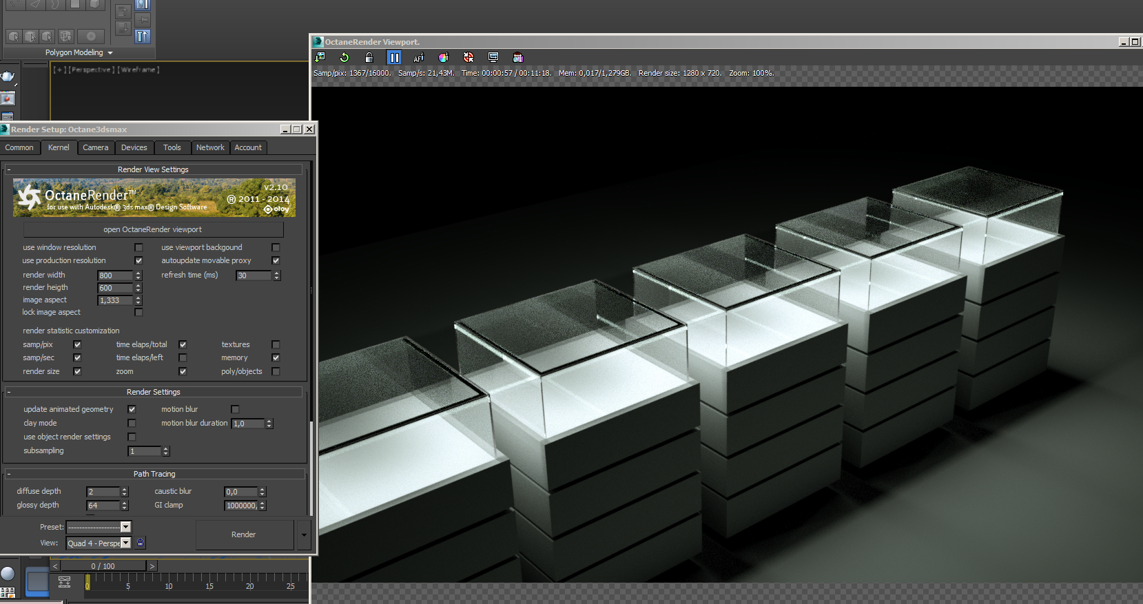

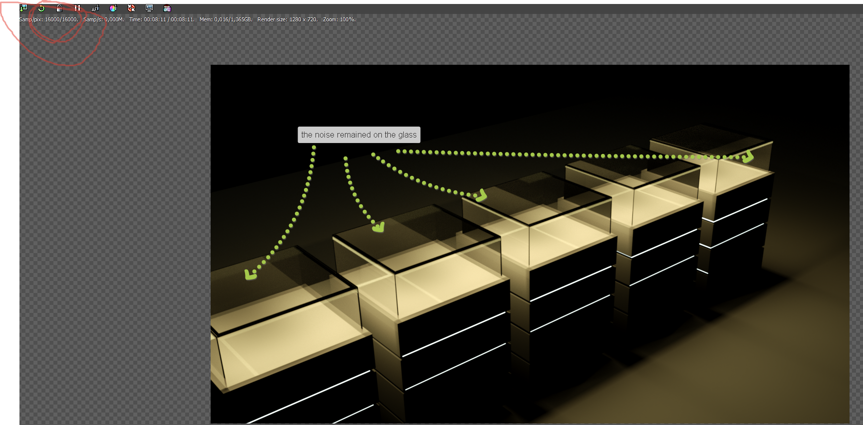

1. the noise remained on the glass - Path tracing

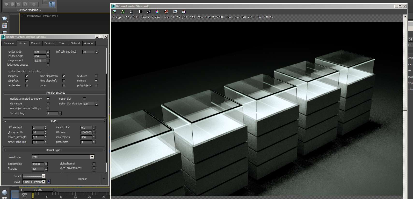

2. PMC - the noise was gone, but the whole picture is noisy, very long time
3. corona render - here the glass is just noise, but but but 1 CPU!!!!!! octan render GPU 780+780+590
:mrgreen:

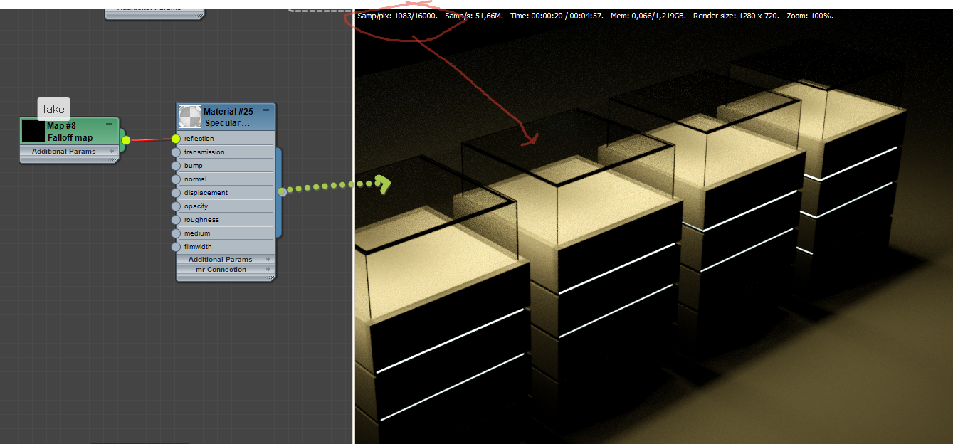

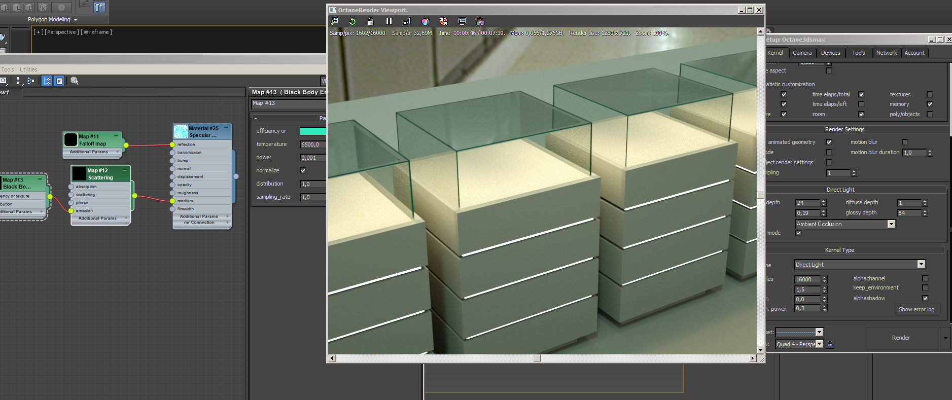

found the first option ///// mmmmm more and more I think about mental ray ***** the Bolon bloated noise from nothing ****** .....but I still love octan render ---- - animation he is the best ( not talking about the interior:) :) :) :) :) ) p.s. = although I often use in animation render quickisilver hardware

Goldisart wrote:what options there are to optimize the noise
Just enable the "fake shadow" option in the specular material.

abstrax wrote:
Goldisart wrote:какие варианты существуют для оптимизации шума
просто включить "поддельные тени" в отражающий материал.
http://render.otoy.com/forum/download/f ... &mode=view - :)

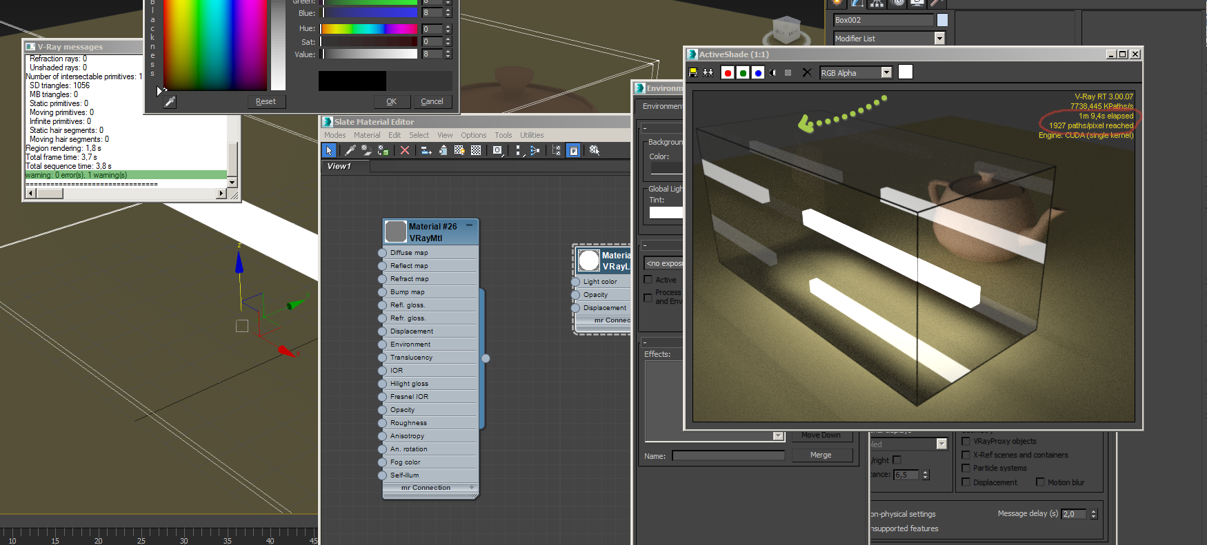

Tell me that I don't sleep ....?!?!?
Tell me why I bought a graphics card for $ 2000 ?!?!?!
.... You need urgently to persuade me not to buy a render farm for Vray :twisted:
