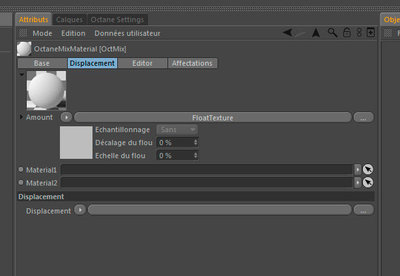

For displacement with mixmaterial, you need to use only the displacement tab of the mixmaterial. Not displacement of inner materials. You need also to activate the checkbox of this displacement tab. By default, it's not activated.

I don't see any diplacement tab on mix material inside of c4d. There is only Amount, Material1, Material2. If i assign the displacement on the amount nothing happens.

Indeed, if you double-clic on the material, you'll not see the displacement tab. But if you have a look at the attribute panel with the mixMaterial selected, you'll see a "Displacement" tab... ;) But you're right, it should be there with double-clic. Globally with Octane plugin, the attribute panel is more complete than material panel. If you don't find it in material panel by double-clic, it should be there in attribute panel.

Thank you very much. It's working now. I never edit materials from the attributes panel...that's why I didn't saw the extra options there.
