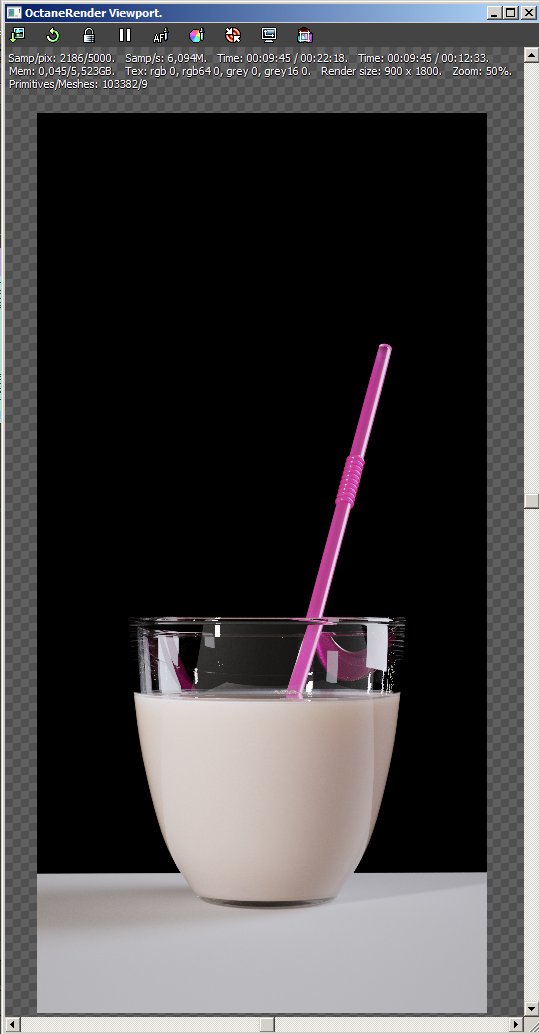

Here are my tests :
Image 1 - Octane 2.06 - 9min45 - 5000 Samples/pixels
Image 2 - Octane 2.10 (few more seconds... sry !) - 10min38 - 1811 Samples/pixels
Image 3 - Octane 2.10 with Coherent mode (PathTerm 0.3)- 6 min - 1347 Samples/pixels
Image 4 - Octane 2.10 with Coherent mode - 9min45 (same as image 1 this time) - 2186 Samples/pixels
Thank you boys, that's a really nice release, the noise disappears insanely fast !
