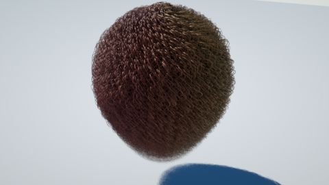

I don't know if the fur works, but I've gotten the simple Maya hair to render by making sure it outputs to polygons. As for the texture, you can't use the built-in coloring (it doesn't work with Octane right now). You'll have to apply an Octane material.
I just made a simple example of "Fur" using Maya hair.
Thanks zboog,
I did some test also with the demo version. Thanks for the example. What I am aiming to do is that the hair color gets its texture information from the mesh it is applied on. Like a checker or anything else. If I have to texture a Panda I will need white and black textures all over the body.
